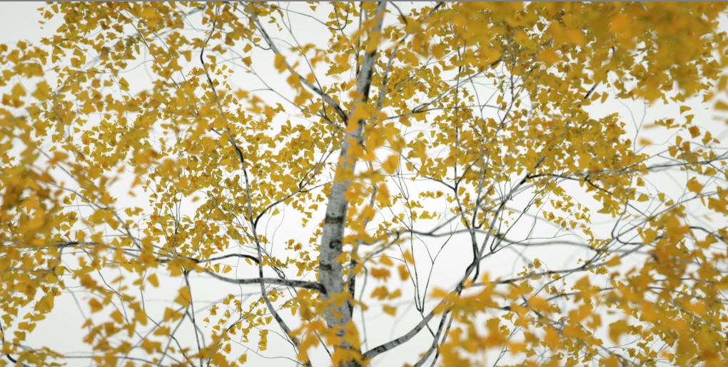

i was working on a tree model (for use as proxy in sketchup) in the standalone, when i saw this default view, i wondered if one can get the same view in sketchup?
sharp middle ground and blurred foreground.
i checked the settings in both the standalone and sketchup plugin, but they are not exact the same, but i guess they are all there, but the 'pick' auto-focus is missing in sketchup :-/
thanks
jorgensen

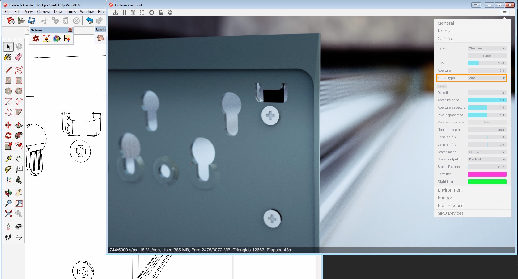

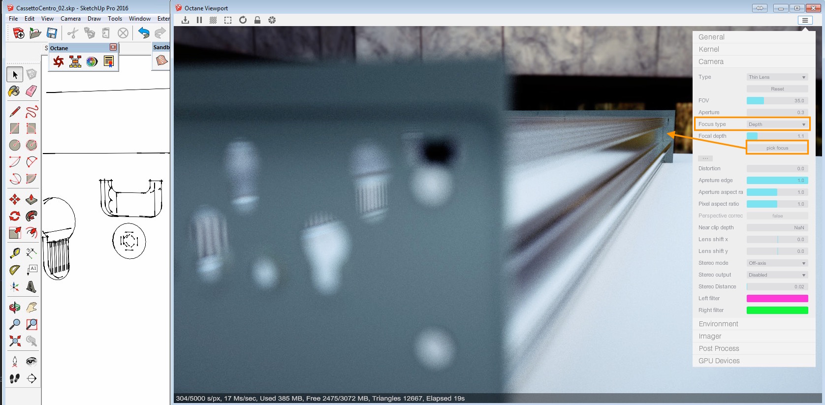

Hi jorgensen,
look at these screenshots:
firstly in Auto mode
then in Depth mode and by clicking the "pick focus" button
Happy rendering,
ciao beppe

Ah thanks - beppe.
i simply overlooked the "pick focus" button.
thank
jorgensen
