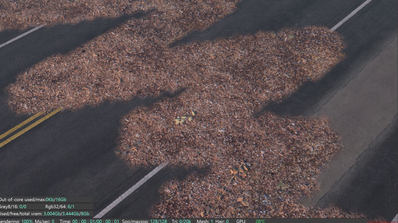

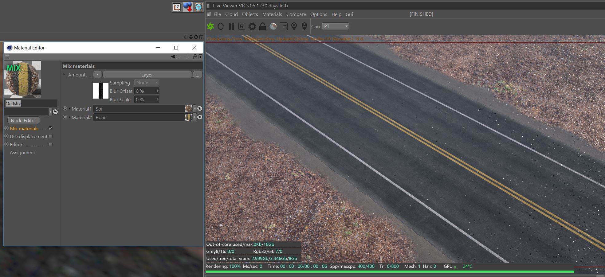

I'm attempting to blend various different textures using mix materials and masks but I feel so limited at the moment. C4D masks work but I've baked it to an image texture to reduce complication. So this could apply to Standalone too...
See here an example of what I'm doing..
My displacement for soil isn't working in the mix material, neither is my roughness by the looks of it. Normal maps do seem to be working I guess which is weird. If I use displacement in the the mix material it applies to the whole thing which is not what I want, as there is variations in materials and surface which all depend on their own maps.

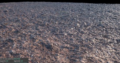

This is the soil on its own..

Hi mikeadamwood,
unfortunately OctaneRender displacement has several limitation. What about using Bodypaint for create your masks and textures in large format for all the necessary channels?

with Bodypaint you don't have all the substance shortcuts, but you can create your custom brushes and paint with your textures on different channels at the same time, you are not limited at 8k, and you can also fine manage the geometry uvs.

Im not sure if this works for you, but what I often do in these cases is to simply use 2 overlapping meshes. You can use the sculpt tool to modify the parts where they intersect. Might be a dirty way to do it but it works.
