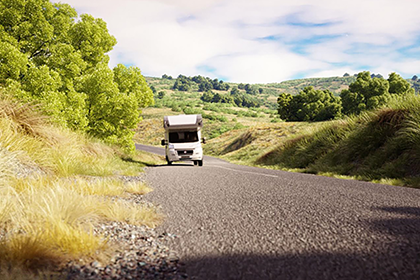

What's the proper workflow for blending environment textures that have multiple channels(diffuse, normal, displacement). In native C4D I would potentially use body paint to mask out say a riverbed or I could even use vertex maps to some degree.
Similar to the video posted by Otoy how the road blends into grass etc...
Of course this next technique is really good if your using standard tools
http://motionworks.net/shop/creating-na ... ironments/
I'm thinking I may have to use an external package but even substance designer/painter has limits to texture size which is no good for landscapes. I know I can get good amount of detail with scatter object and clones but getting realistic material blend down is proving impossible. People are doing it with Octane cause it's all over instagram so I must be missing something.

Hi Mike,
I think that you have picked the perfect example that demonstrates the power of scattering objects in OctaneRender™
Everything you see in the video's environment is scattered geometry or displacement, even the clouds are polygonals
I'm sure you are going to have a lot of fun with scatter objects in c4dOctane since you can also use vertex maps and Mograph effectors
ciao beppe
