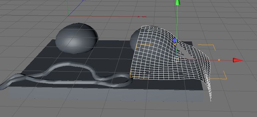

Hi, I've uploaded a project file that shows what appears to be a bug.
http://keithlea.com/in/soft%20body%20octane.zip
Seems that splines with soft body dynamics are not exported correctly. I have another project where a Plane softbody isn't showing up as deformed either, but I can't reproduce that in a smaller isolated project.
Any thoughts? Workarounds?

colorlabs wrote:Hi, I've uploaded a project file that shows what appears to be a bug.
It looks like a bug in the Dynamics tag: The generator cache is not updated properly. You can see that, when you try to make the circle spline editable or when you try to convert the current state to an object. There is unfortunately nothing I can do, as the data that is delivered to the plugin is incorrect. Even baking doesn't help (tested in C4D R12.043).
