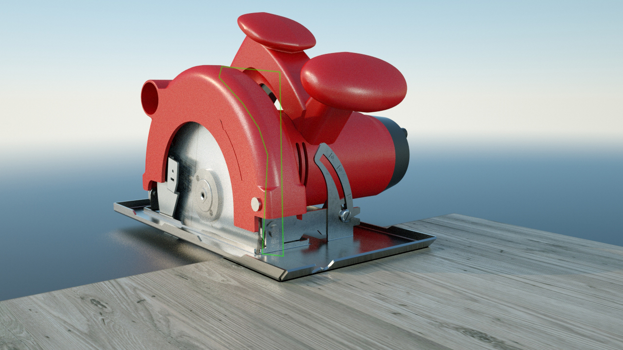

Here are some screens.
Rendering OK
Rendering OK
Here you can see the problem.
A light white square around the blade.
Thge blade is going smaller
Inside the green line

Looks like you mixed up.
1- What's your passes? If you have motion blur pass then mblur effect will be disabled.
2- If you see scaling kind results on rotating objects this means that rotation is very fast and flipping effect occurred. So you need more time_sampling. Increase it from Render Settings. It's just for Picture Viewer not for LV.

the solution is: decrease the rotation speed of the blade. thanks to aoktar for this tip!
