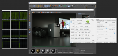

Okay, this is strange, as well... all three GPUs are maxing out at only 80% usage... I have them all set to use the max 120% power target. How do I increase that to get them all to 100% usage?

to give You propper reply. based n numbers & speeds..
gk110 based cards like 780Tis or Titan Blacks could score around ~110 in OctaneBench
1080s for now score ~140 & in some cases 160.. so 3x 140+ is around the same as 4x 110..
Consider the fact You're comparing High end card from one generation to mid end from other generation..
Again the same mistake as Guys made comparing 580s (hi end) to 680 (mid end)
High end from Pascal line is TitanX & probably upcoming 1080Ti. TitanX (Pascal scores over 160 out of the box for now).
So the results are as expected, but You expectations were a bit too high based on misinformation
(maybe You looked at gaming performance comparisons or so..)

if You're running Path Tracing kernel, bump PArallel samples & MAx tile samples to maximum. GPU usage will not change too much but on some scenes You can cut render time by 10-15% ;)

No... no other expectations other than "newer + faster = better"... I just relate it to the rest of the computing world components. Still can't figure out why the cards are topping out at 80% usage, though.

glimpse
Posts: 3740
edensoto wrote:
mesut wrote:
edensoto wrote:... Still can't figure out why the cards are topping out at 80% usage, though.
try unchecking "low priority" in your devices settings in c4d.
None of them have priorities set (low or high)... none of them are checked
It's normal behavior on v3 builds.. - even Your older 780Ti would not run as high as they were running on v2.
