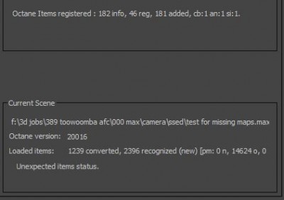

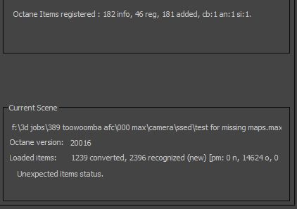

Im getting all white materials in a v2 scene when opened to v4.04.3 -4.26
I was having good results until now with the conversion. there is a message about "Unexpected items status"

Hi Paride,
Ok, after testing a lot of options, i got it to work once these things were done:
- removed xrefs while in 2.x
- made sure corona and vray was installed on the 3.x version
Only when all of these were done did it work. i think the conversion needs to be robust enough to ignore corona and vray proxies if they happen to be in the scene or at least make a warning.
Let me know if you can fix these issues. Thanks Paride

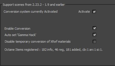

Also i have attached an image of my settings. The objects that are dropping textures are all local objects not xrefs.
