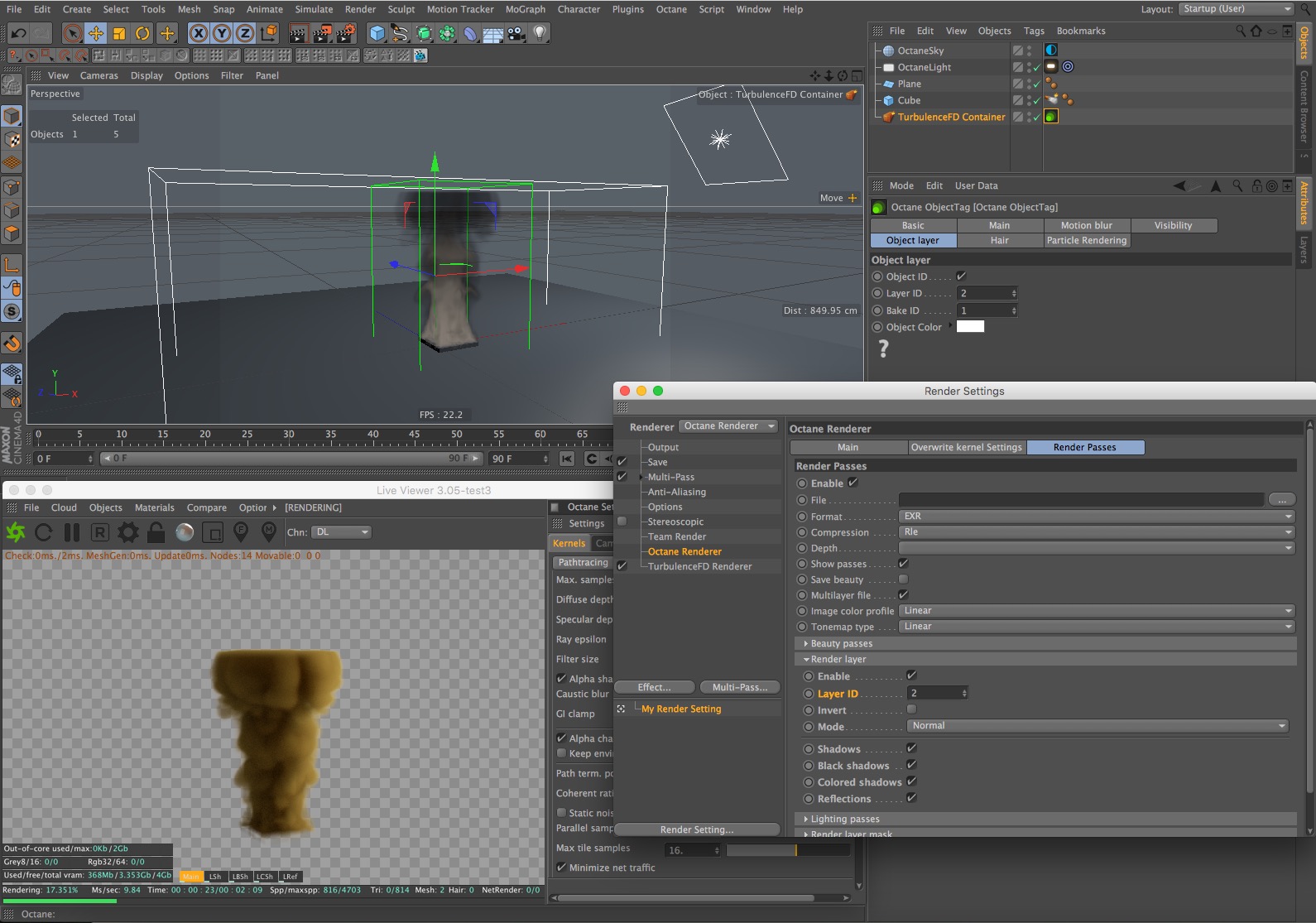

Hey guys,
I'm just getting tired of finding a way to get a Mask or Alpha Channel for my TFD Volume rendered in Octane.
Is this even possible?
Very looking forward to any ideas!
Thanks in advance,
Lucas
Posts: 10623
Hi Lucas,
volumes are different from polygons so is not so obvious, you can obtain some useful passes if you enable the Render Layer mode:
ciao beppe

Oh of course, so easy!!!
