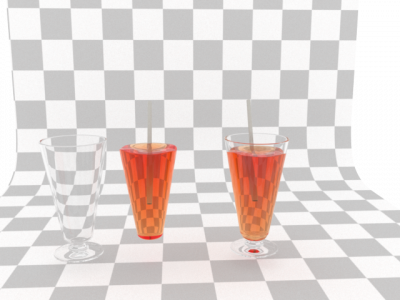

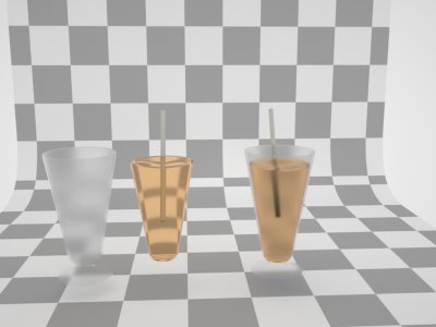

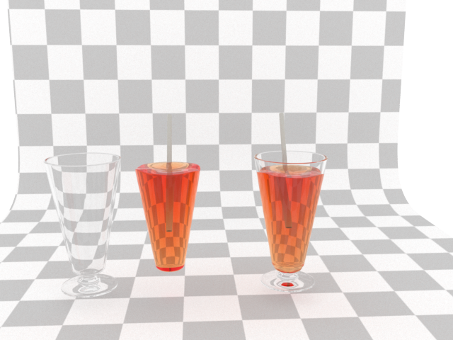

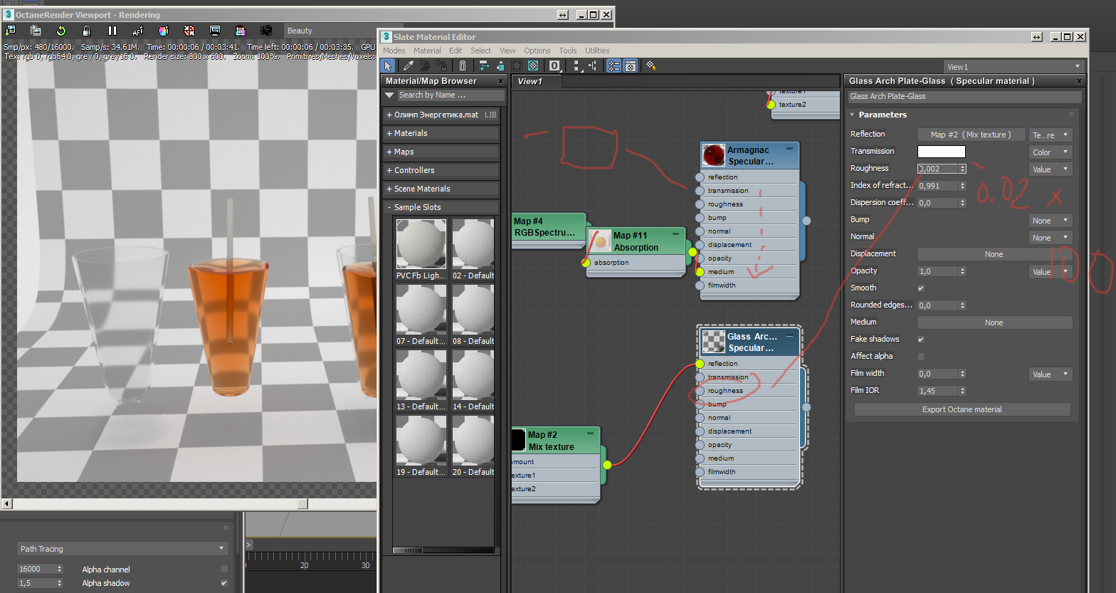

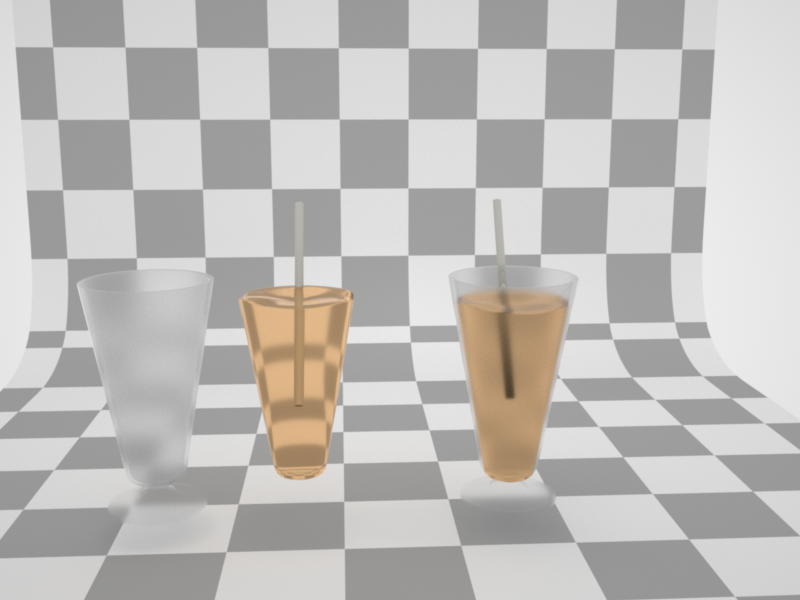

lay out some thoughts about gender conversion
1. picture Vray
2. after conversion to Octane
... small fixes that would improve the function of converting

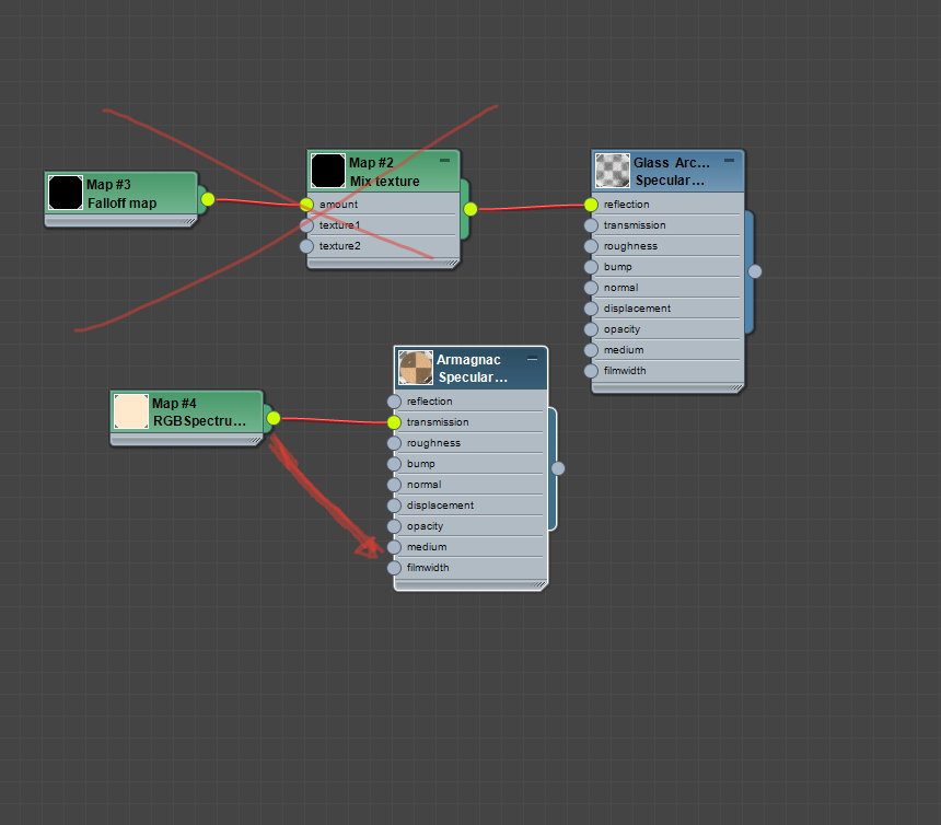

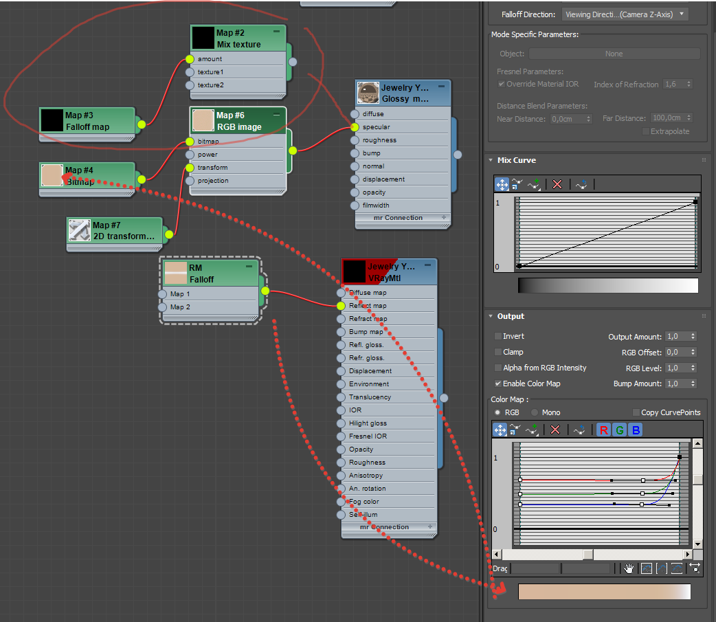

when converting a metals - there is generally a wrong conversion because the metal color is in gradient map

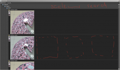

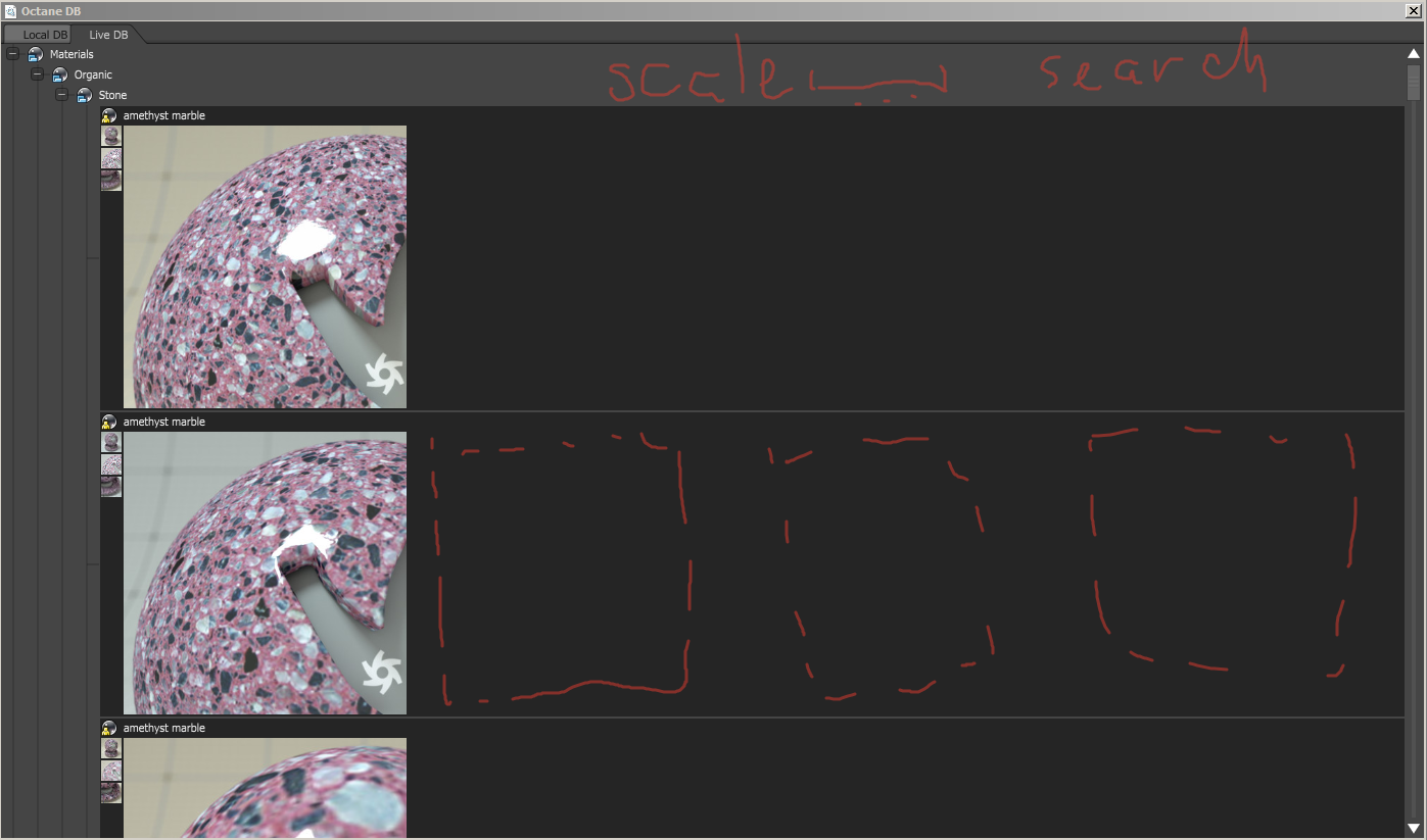

I thought that using this package I get verified the correct texture when converting but come to the conclusion that we need to create a convenient database of library materials LiveDB unfortunately terribly uncomfortable ... and work with it only when transferred to the computer ... if Otoy has created a similar program material to support it would be very great !!!
minuses 1 from LiveDB. work slowly if low speed Internet 2. there is no search . 3 is not optimized program 4. there is no possibility to download the package and install stationary without Internet .. have to pump the entire library
there are materials which have no place in this library or repetitive or with low texture
