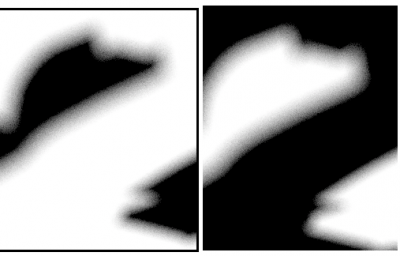

There is a problem with render layer masks when there is DOF in camera *AND* there is Alpha Channel enabled in Kernel settings. It makes layer masks render like if there was Distributed Rendering turned off, while it actually is on.
As soon as I uncheck Alpha channel in Kernel settings the problem goes away, and the masks are perfectly matching DOF blurs.
I am not using any other render layer features or passes. Just main beauty + ID masks for 3 object groups.
Quite a bad surprise for me, getting humiliated in front of a client as I sent them botched masks without even realising something's wrong... I didn't know the kernel alpha setting could have such consequences...

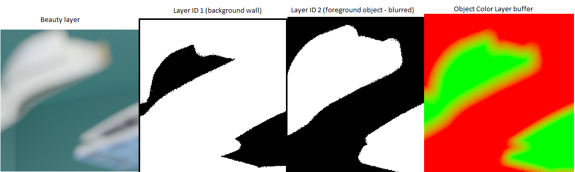

Interestingly after the fact I did some tests and it seems an Object Layer Color buffer seems to be properly blurred (while layer ID masks are still "hard").
See attached what I mean...
The picture on the top shows properly blurred layer id masks when Alpha is disabled in Kernel options - and that was the only thing I changed and re-rendered.
Cheers,
B
properly blurred id masks (Alpha turned off in kernel settings)
Hard id masks (Alpha turned on in kernel settings) - interestingly the layer color buffer looks properly blurred....

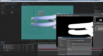

Posts: 16066
Location: Türkiye
I don't think anythings like that but this has been asked many times if i got it correct. And answered as much as. See my picture.

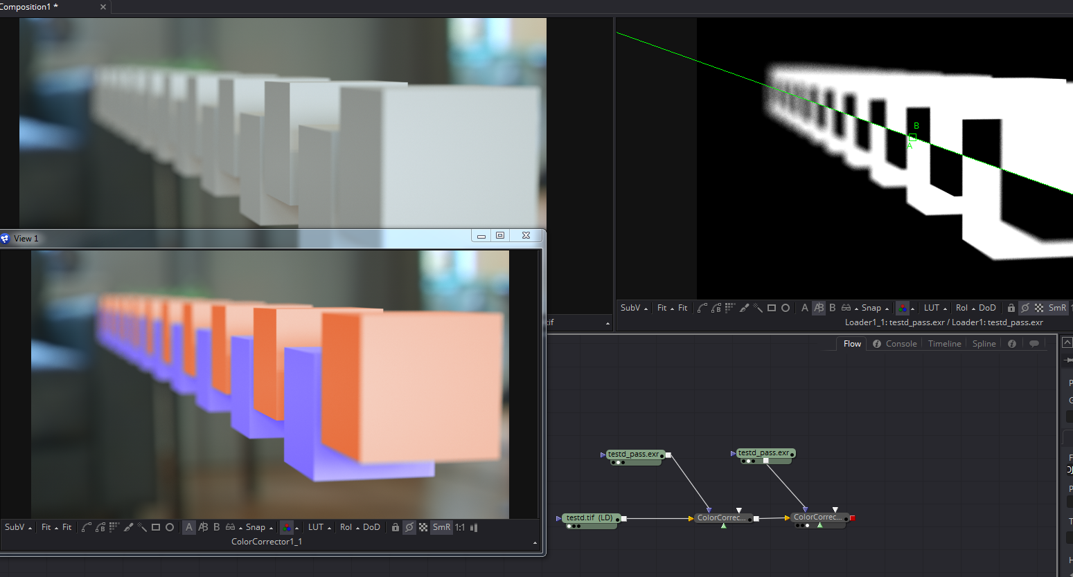

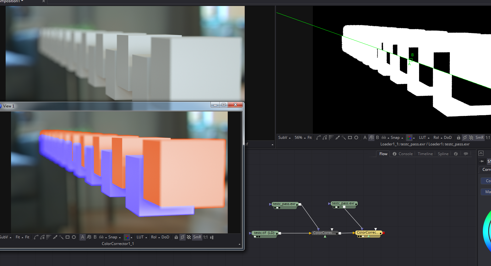

Can you please explain this?
The only difference in settings between those 2 pictures is disable/enable alpha in kernel render settings.
Alpha disabled in kernel
Alpha enabled in kernel
Posts: 16066
Location: Türkiye
I can't see any difference in After Effects for saved images. This mask think is a extraction from render_layer feature of Octane. It extracts the alpha in extra render sessions. Note that i'm using png format.
bartolos
Posts: 38
Joined: Thu Aug 11, 2016 8:59 am
I was using multi-channel EXR file.
I think there is some logic there which makes those ID masks "straight matte" when there is Alpha in kernel enabled. That way post-multiplying them by alpha smooths them out.
But this is confusing, and does not work when there are more render layer IDs mixed together like in my case above.
I mean - the render layer ID masks seem NOT to be usable like C4D-style Object Buffers.
But now I will happily use the object color masks...
