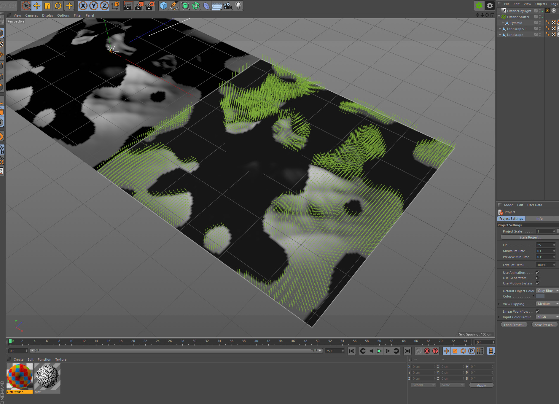

Have a look at this:
I'm trying to scatter some plants on a big place and control their sizes/ distribution etc with noise, but no matter what i do, it ends up with these lines patterns, i tried to scale it and change noise types, also changing from object projection to world. , nothing really works, any ideas on how to solve this?
I'm using 3.03.4 R2 on cinema r 17
Thank you for your attention.
Cheers.
Raf

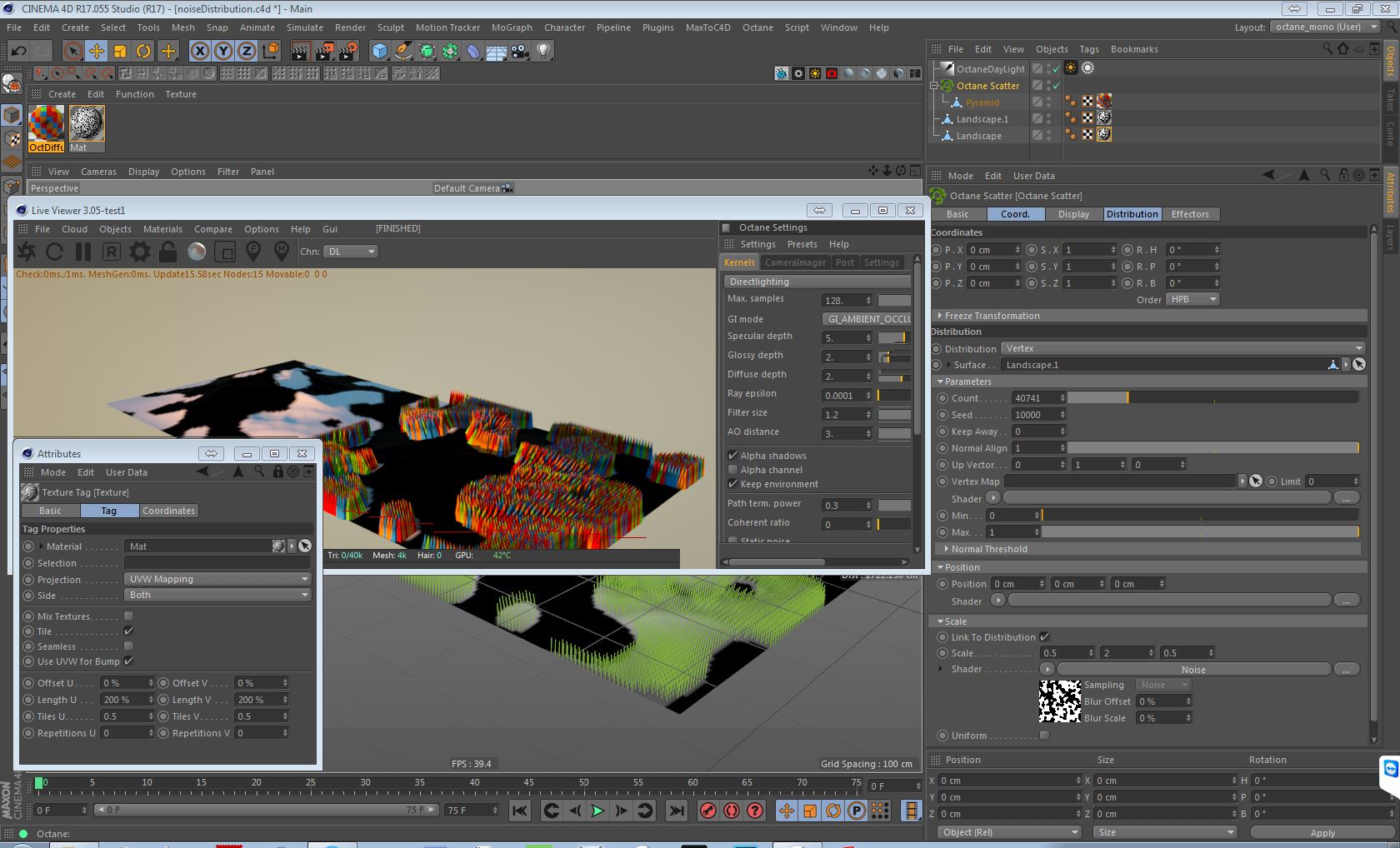

Hahhaha, it does look like a bug, just opened your scene, and have a look at what i've got. Stripes!
Will update.. let me see if i can find a solution.
Cheers!

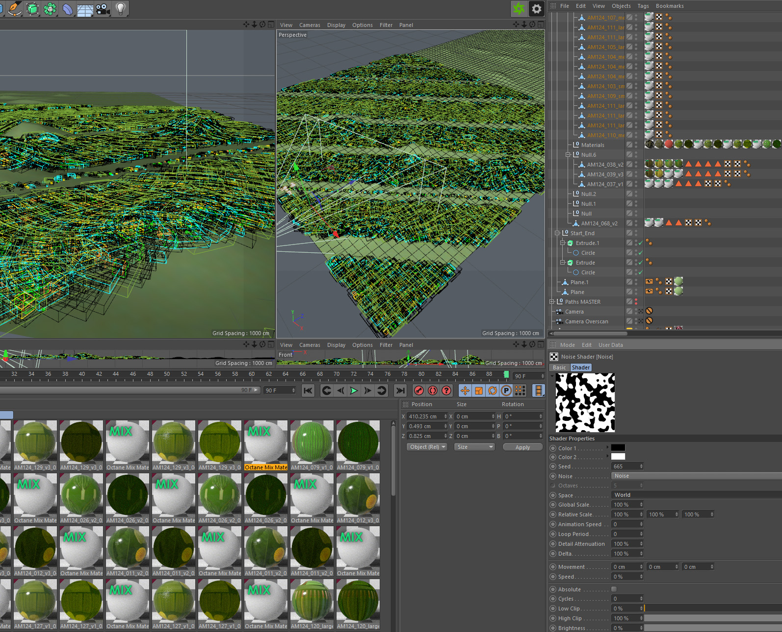

Updated to the latest stable version and i stil get the same behaviour. :(
