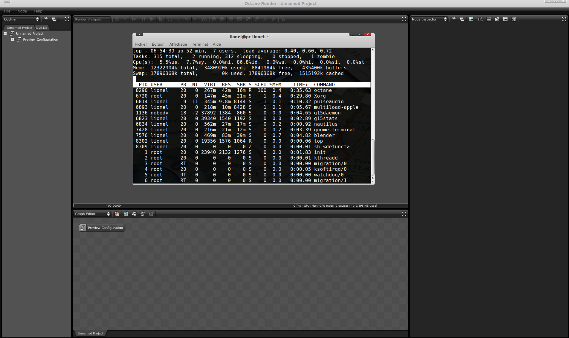

I didn't notice so far as Octane is always taking lot of CPU on Linux while rendering, but it appears it anyway takes steady 100% CPU shortly after loading, with no scene loaded.
Any clue?

That observation was the first thing I posted, when joining the club
Try to keep your mouse on a menu (just open the file menu, for example) - that will turn down the CPU usage to "0%", but when you close the menu, it will go back up to 100% = interesting and something worth to inspect.

This is not a big deal, but yeah, it should be looked into. Basically:
* if you start Octane and don't touch anything, there is no CPU usage
* the moment you enter and exit a menu (any menu), Octane starts to use one core at 100% and it will continue to use it until you close the program
* every time you are inside a menu, the usage will drop back to zero, when you exit the menu, will raise back to 100%
All this happens without loading a scene.

I'm getting the 100% CPU usage as soon as Octane starts, without touching anything.matej wrote:* if you start Octane and don't touch anything, there is no CPU usage

Interesting, I have to touch something first (like open a menu or toggle preview tabs in Node inspector)yoyoz wrote:I'm getting the 100% CPU usage as soon as Octane starts, without touching anything.matej wrote:* if you start Octane and don't touch anything, there is no CPU usage

Just booted over to my Ubuntu and tried on both 2.43 and 2.44. My experience mimics MateJ's. No resource useage until a menu is poked, then one core pegs.

when we did our linux port early last year, we ran into several threading / locking issues with X11,
which required a copious amount of Xlocks to be added to the GUI library.
I am pretty sure this is the messaging manager that simply spins in a loop, and at various times calling X locks,
which cause quite a bit of additional system call load.
Can someone post some detailed 'top' screenshots so we can see the type of load it generates ?
Unfortunately it's not easily fixed, as the developer of the GUI lib has already commented on it by saying he does'nt use linux,
and i have no clue where to start looking in his haystack of code. (this was early last year)
We need to upgrade it though, and newer versions might fix this.
However due to a few customizations, we can't simply build with a new version,
so it's not something i like doing when there is no clear problem,
but this could change that.
Any way, we are currently swamped with more severe stuff to fix/implement. (rewrite of multi-gpu render core, new kernel and much else),
so I think you will have to tolerate this for another few months...
