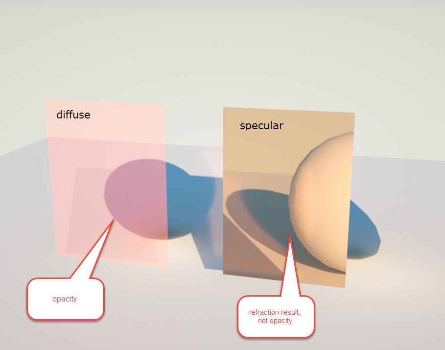

The thing that you assumed and camera visibility are not same for renderers. Especially for Octane. Camera visibility means first hitted surface point by camera ray. It's not done by first ray when you see any object by through surfaces.
