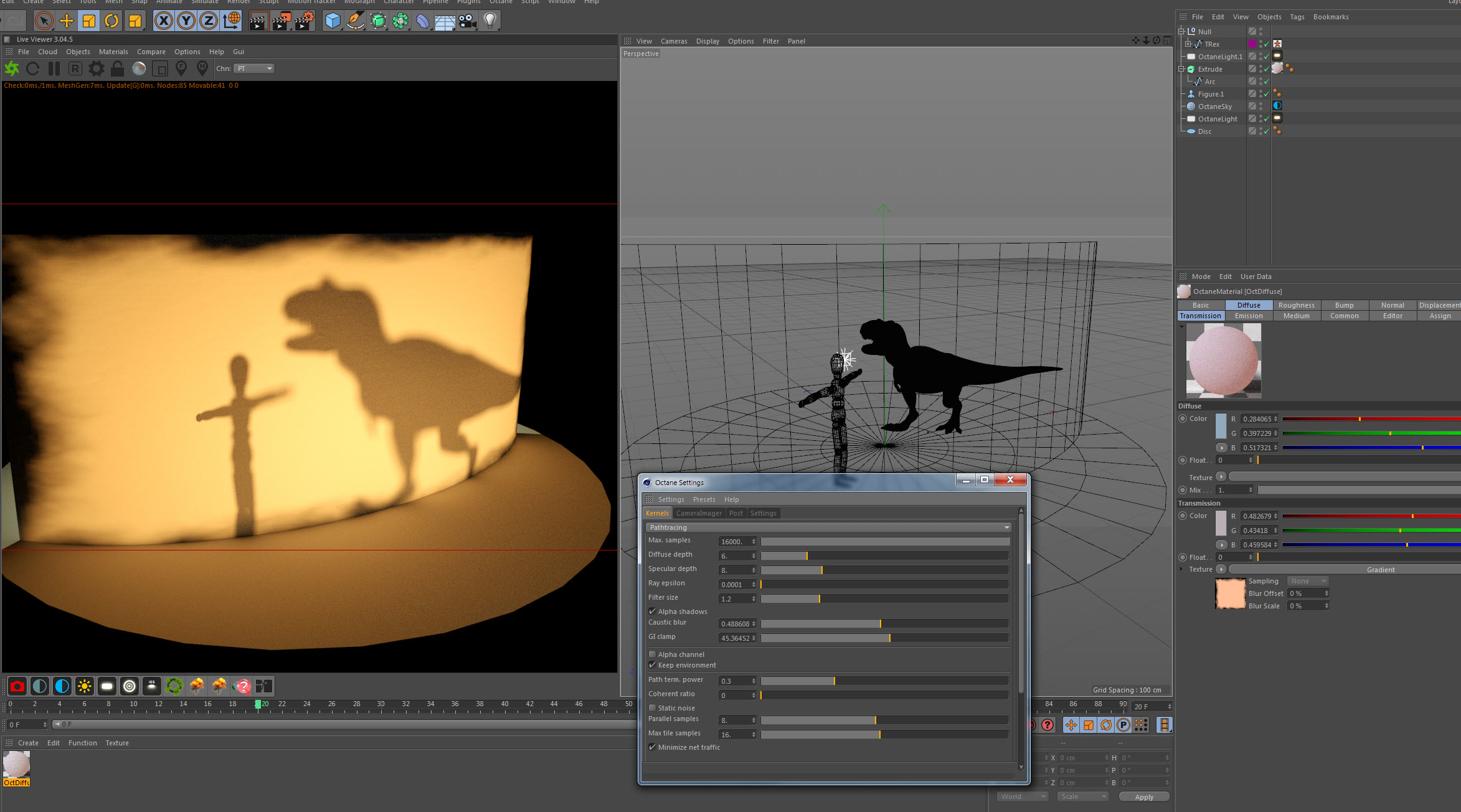

yes, that's what I want to have ! Thank you.
could you share the scene ?
You don't use any light ?
Posts: 16068
Location: Türkiye
mips wrote:yes, that's what I want to have ! Thank you.
No :)
I showed all you need. Please it's 2 minutes to do!!!
Hint: see transmission slot

Hahaha Ahmet I was just about to post this but you were faster (as usual). Funny how we both went for a dinosaur :)
Hey mips
You need:
1. Small area light for sharp shadows (optional image in distribution channel for a spotlight effect)
2. Diffuse material with dark diffuse color and bright transsmision color
3. A dinosaur.
IMPORTANT: Make sure to use the latest 3.04.5 version because transmission is broken in the previous one!
Regards
Milan

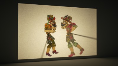

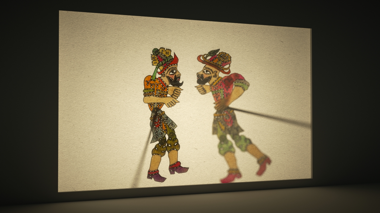

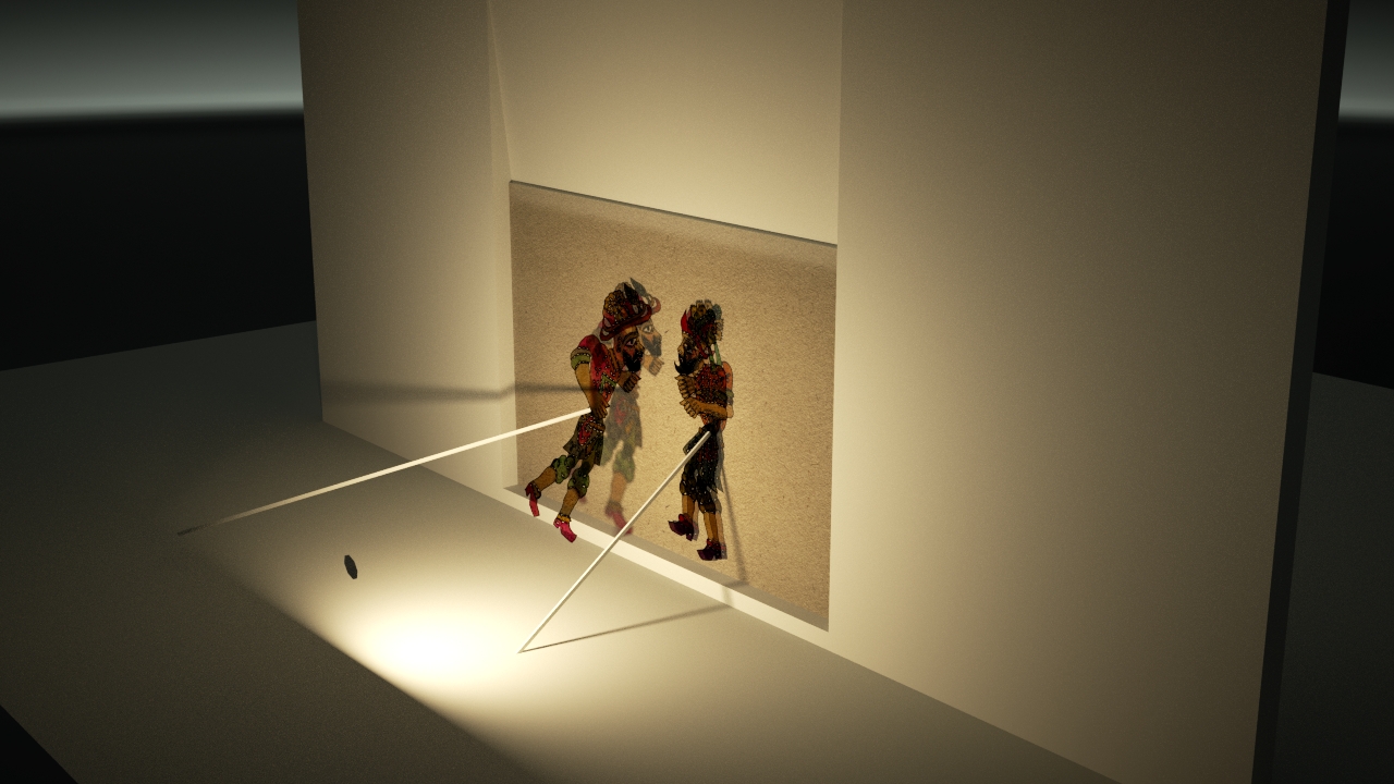

Here is my approach on shadow. This time Turkish shadow theater :)
The puppets are transparent as well.
Using specular material with fake shadows does the trick.
