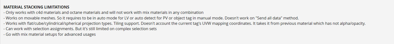

2-Stacking by same way as in C4D materials. Read attached image for limitations.

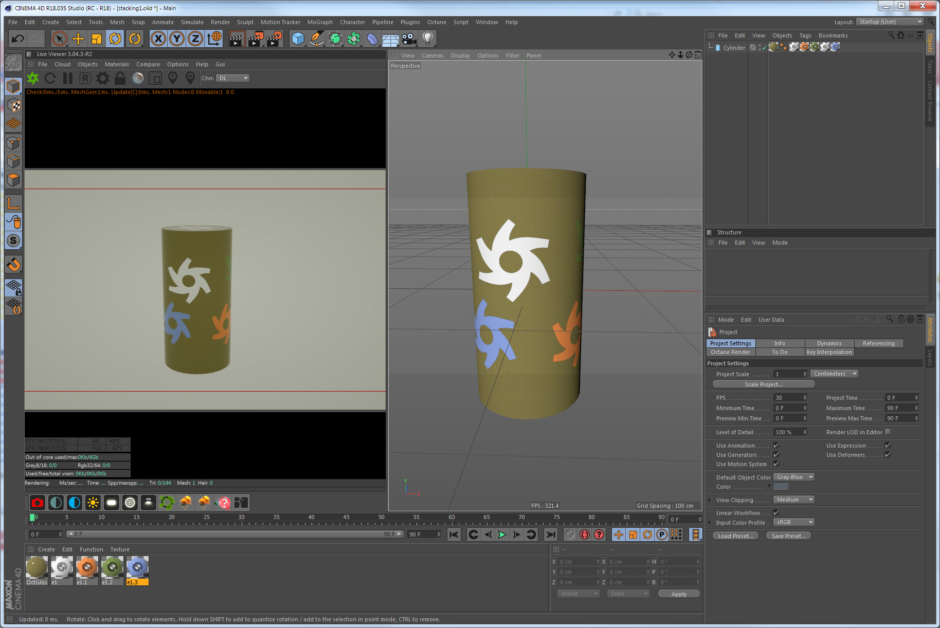

3-Find attached sample scene.
Note that Octane is not C4D renderer and a GPU renderer. It not works as a CPU renderer and it requires a lot of tricks to get same features.
