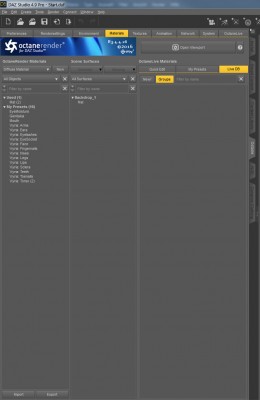

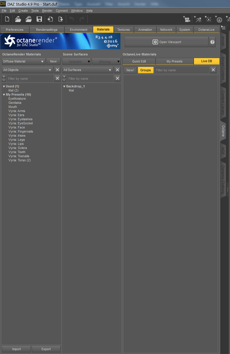

The names are missing, there are no groupings and they are not displayed under "My Presets".
Also, if I clear the cache and re-update Live DB does not work.
Sometimes helps when I delete "OctaneRender_settings.oczdb" in the "OctaneRender / Data" folder.
But almost always when I start DazStudio Live DB does not work.

Do you have any idea?
I have already searched the forum but nothing similar, I seem the only one with this problem.
The error was for all versions V2, V3 Stable and R4.4.4.28.

I once had that. Check the Map cache path under the Octane->Preferences tab is correct. Mine got corrected after I fixed that and did a Clear Cache followed Update Now!.
If your path is correct then I suggest you take note of the paths under the "Path Settings". Then uninstall Octane Plugin. Delete or rename all the octane paths you noted down. Also use regedit.exe and go to the registry and go to HKEY_CURRENT_USER\SOFTWARE\DAZ\Studio4\OctaneRender key on the left hand side panel and right click and select Rename to rename it to something other than OctaneRender e.g. Old_OctaneRender . Then re-install the Octane Plugin again.
Hopefully that will solve your problem.

You could try deleting OctaneRender_livedb2.oczdb from the OctaneRender\Data folder and then re-download the livedb (or reinstall the plugin).

I have now deleted everything also the registry entries and reinstalled . Now seems the error fixed (until now).
Thanks rajib!
