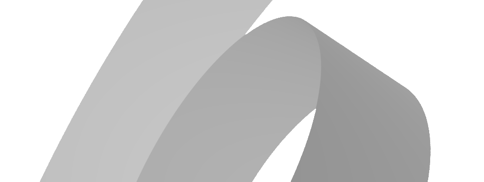

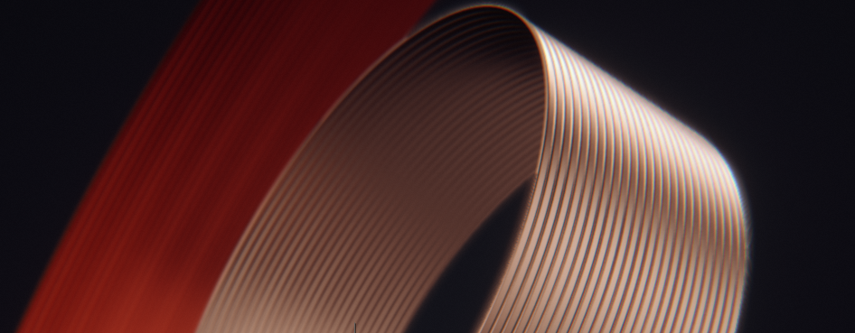

In terms of edge pixels in z-depth... is there a way to resolve? Getting edge tearing on my DOF in post. Probs down to antialiasing.
I read in another thread beppe that you advised to use Non-linear tone-mapping and to check Disable partial alpha to fix. This hasn't done the job for me. (I'm guessing by non-linear tonemapping your just referring to the Tonemap type dropdown in Render settings? Set it to Tonemapped?)
viewtopic.php?f=27&t=50500
What's the best practice in C4D Octane to reduce or remove edge tearing pixels in the Z Depth pass?

about antialiasing issue, please could you post some screenshots of your particular issue?

I might try to render the z-depth 2x the size and scale it down to resolve this... I've read a few posts where people have suggested this to resolve bad edges when using lenscare.
What settings could result in jagged edges / influence antialiasing - to give me ballpark to know what to tweak.
Samples? Object tag? Alpha settings?

Hi Brezaling,
make sure that you have not disabeled the Distributed ray tracing option in the kernel settings or in the Render pass Info passes section, otherwise all the info passes are rendered without DOF and mblur.
What is your filter size value?
