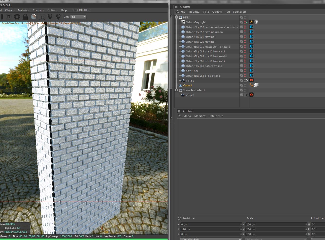

Can anyone confirm that using stacking material the displacement (on the base material) won't work?

Not surprising. Because mix material needs own displacement input.

Hi Ahmet, so what could be your suggestions in order to have:
- material A with displacement
- material B with no tiling placed in the correct zone (as a label)
Thanks again.
Luca

It's hard to manage displacement with stacking feature. My advice to use our old mix material system in this case and use displacement in mix material.
