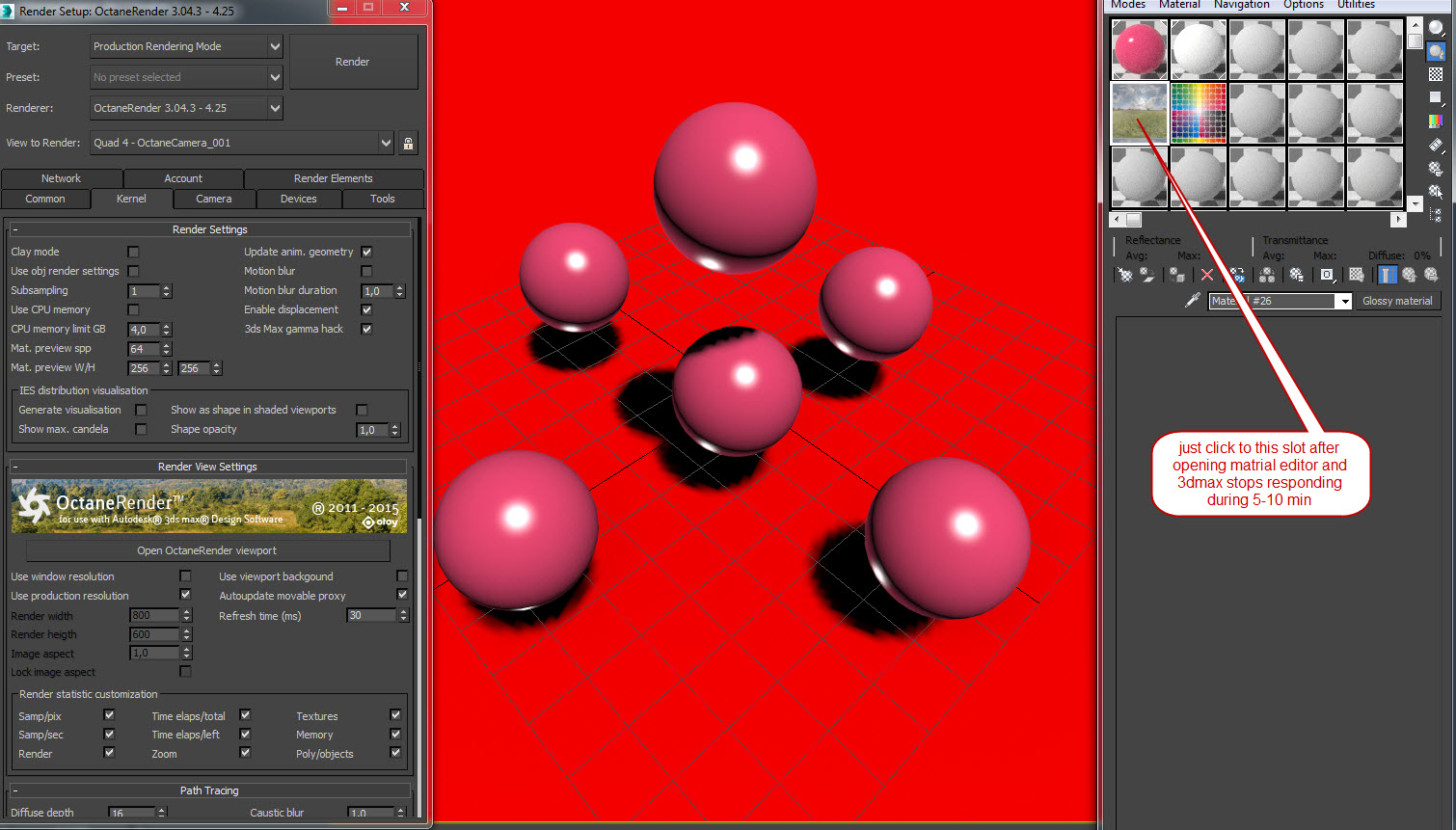

Freeze
Win11/msi x79a-gd45 (8d)/ Intel Xeon e5 2690v0/ 64gb DDR3 1866/ Nvidia 4090 Asus TUF/ be quiet! Straight Power 11 1000W 80 Plus Platinum
AlexMakhov
Posts: 21
Joined: Thu Feb 12, 2015 12:22 pm
+1.
Same problem.
The program stops responding during 5-10 minutes after change any parametrs.

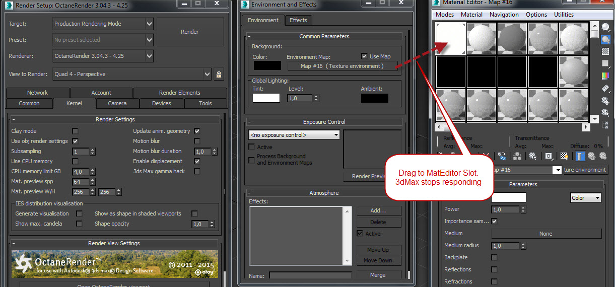

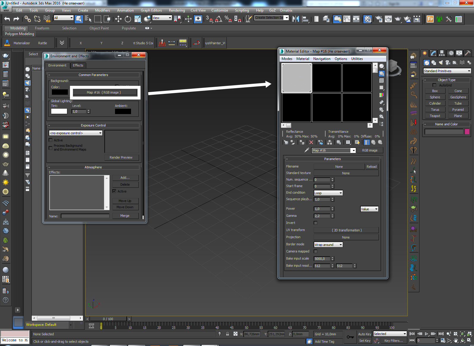

Hi guys,
This issue, already reported in previous days, it is very annoying and difficult to detect because it can not be replicated by everibody.
Could you kindly test attached scene by dragging RGB and / or hdri environment map in 3dsMax environment slot and report if you have the issue?
Thank you
Paride
test.zip
(4.41 MiB) Downloaded 274 times

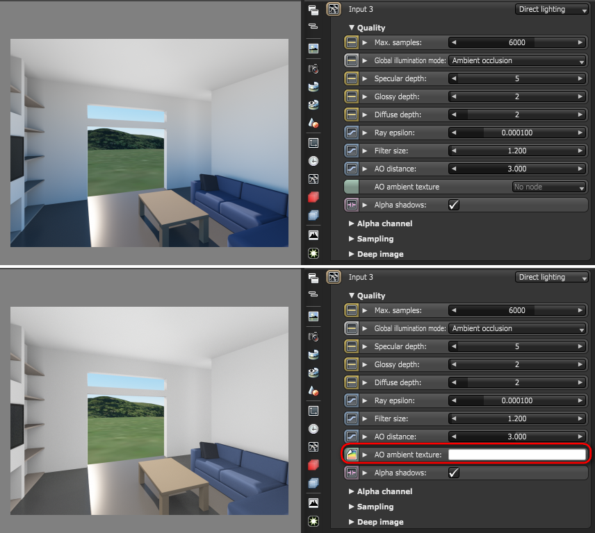

how do we adjust sky color separately from shadow color in AO
AO ambient texture
We added a new texture pin "AO ambient texture" to the direct lighting kernel node, which allows you to specify an ambient occlusion texture which will then be used for the AO calculation instead of the environment. If the pin is not connected, the environment is used instead (as before). This is useful to get rid of the blue tint on white walls caused by the blue sky (top: no AO ambient texture, bottom: white AO ambient texture):"
paride4331
Posts: 3862
Hi coilbook,
I have already asked the developers to fix it.
Regards
Paride

paride4331 wrote:Hi guys,
Thank you
Paride
Hi again.
I tested your scene.
I think it happens when you try to change any setting in the Texture Environment. Drag and drop in the mateditor slot is not the root cause.
