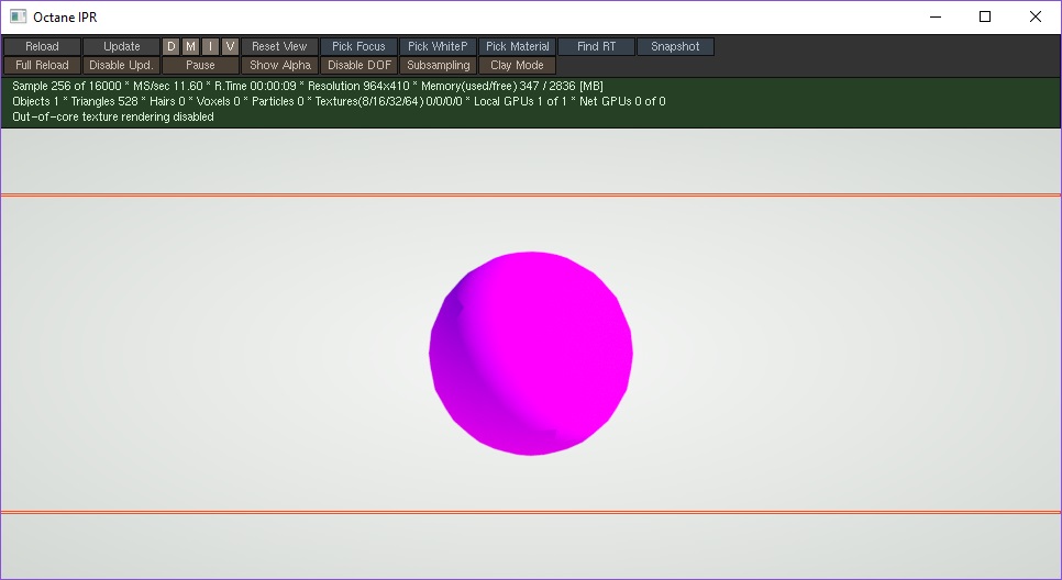

The first time you open the IPR window, it should have the correct image proportions from the camera resolution. If you scale the window you can lose the proportions, but two horizontal red lines should mark the camera limits.

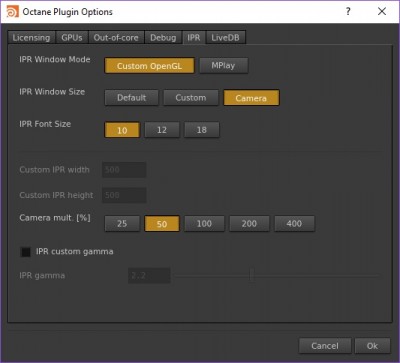

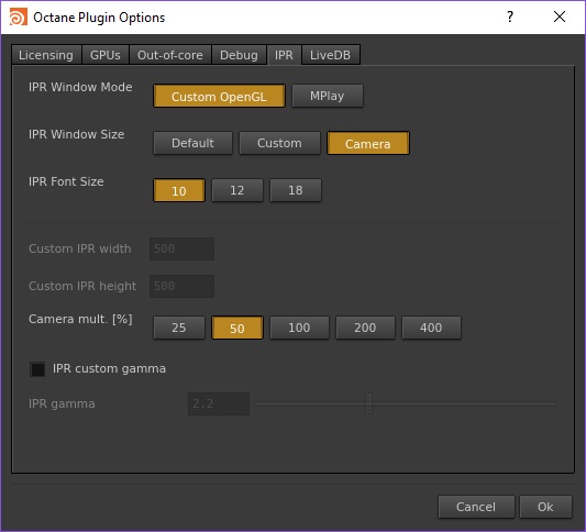

If you want to open always the IPR with the camera proportions, even after scale it, you can configure the IPR Window Size in Camera mode. You have even an option to set the camera resolution multiplier for the IPR. All these options are in the plugin options panel, IPR tab.
