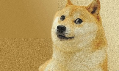

I'm using the latest Octane standalone and modo plug-in versions and I've come up with this but while rendering on 2 machines (4 GPUs)
1/4 of the screen renders faster then the rest. + after sometime it seems that the renders stops clearing up from the noise, even though the samples are still going up.
Really odd.
It looks something like the attachment. Any ideas?

PS. When I used render region the issue is gone! So I just selected as much of the image as possible with render region and it's rendering fine ... :o :?:

LFedit wrote:I think you are talking about this?
viewtopic.php?f=34&t=56346
THIS! :o
Thank you.
I was going out of my mind with this one :lol:
don't you guys think that this checkbox "Minimize Net traffic" should more likely be in the Network settings pallet instead of the main plug-in settings?
It never occured to me to look for it there.
