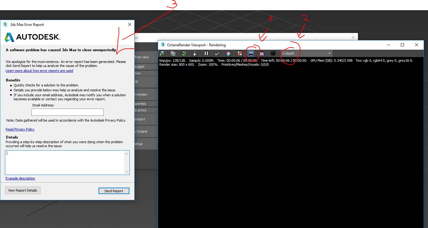

- OK, you didn't fix this zdepth bug - I actually took time to make sure it was the same repeatable bug on two computers and you don't include the fix - guy's I'm busy, and giving my 30 minutes of my time to check for your bugs is making me a bit irritated
- I am doing your job, for free (cause I want it to work) - you should give us another licence for free - cause then my time wouldn't feel as wasted

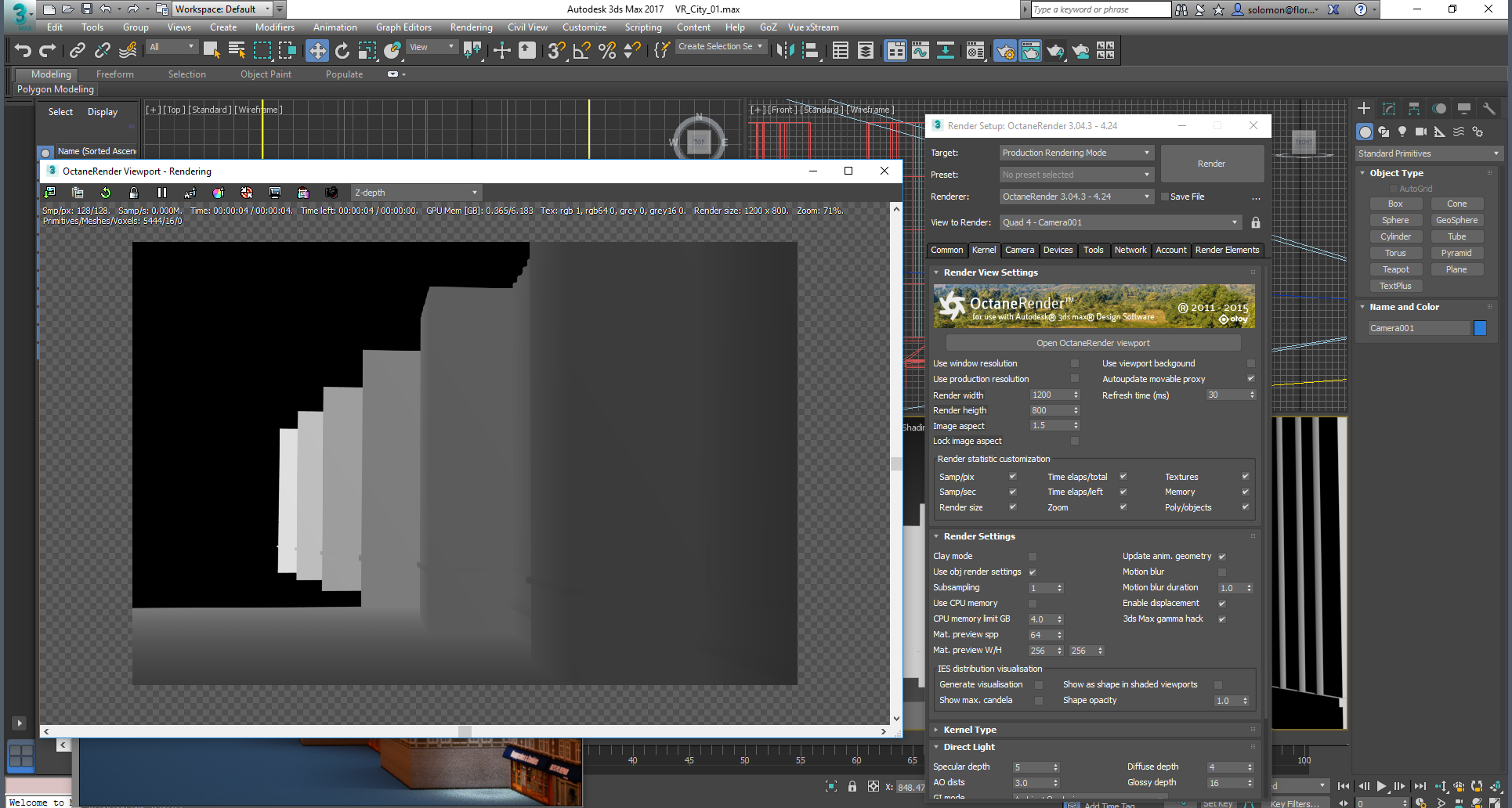

acc24ex wrote:- OK, you didn't fix this zdepth bug - I actually took time to make sure it was the same repeatable bug on two computers and you don't include the fix - guy's I'm busy, and giving my 30 minutes of my time to check for your bugs is making me a bit irritated
Hi acc24ex, what version of Max are you using?
I am not getting the same crash on my end ~ the Z-depth displays correctly when selected from the octane render window
I have attached a screen grab. I am using Max 2017

neonZorglub
Posts: 1050
Hi acc24ex,
I could reproduce the z-depth crash; it comes from using a non multiple of 16 width of render buffer (using the 'Lock resolution' changes the width)
