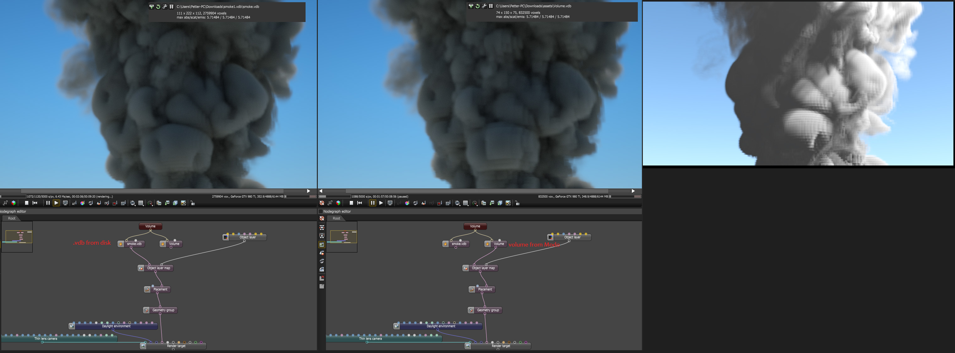

I'm curious though, what causes the resolution to change? I tested on a huge voxel grid just now and the resolution seems to actually have increased after going through Modo Octane:
http://screencast.com/t/dah5IocSRa
http://screencast.com/t/m0QUnNKF

In summary - Octane is not reading the VDB directly. Instead, the plugin is querying the .VDB file through Octane to get the resolution, and this resolution is then being used to sample each point in the volume in Modo. Unfortunately Modo places .VDB files differently to Octane - so it's necessary to get the "Modo version" of the Volume information, rather than simply supplying Octane with the .VDB filename in order to get Octane to match Modo. If the increase in resolution is an issue, let me know (and provide the .vdb you are using for testing) and I can try to get a closer match.
