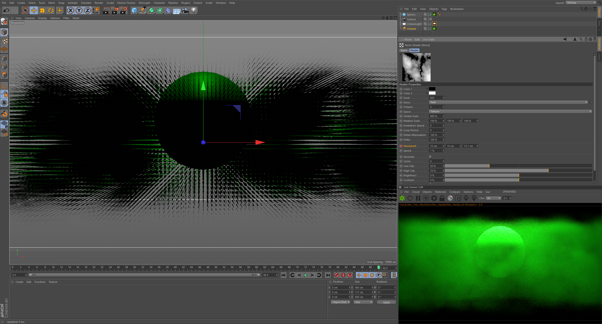

Hi guys,
I might be a little annoying but I can't get it to work too, even after reading almost all the posts talking about the subject.
I keyframed at start the "movement" (15 cm for exemple) and another keyframe at the end (15.1 cm), nothing moves in the live viewer.
"Animation speed" set to 0.2 is working but thats not what i am trying to achieve. I want to use the movement on a certain axis of my noise.
Could someone post something more detailed with some screenshots or video to be sure i didnt miss nothing ? That would be awesome ^^
Thanks !
Here is my setting
Here is my setting
Posts: 10598
Hi jeremyshin,
have you tried with 150 cm on the Z axies at the end frame?
ciao beppe
