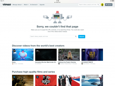

sorry, but I have this error if I try to see your vimeo video:
have you tried to use GPU-Z to monitoring the cards while rendeting?

Hmm, seems like the privacy was wrong. Here is a private link, should work!
https://vimeo.com/197373393/7d38a8de51
