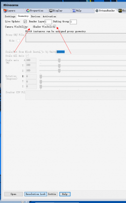

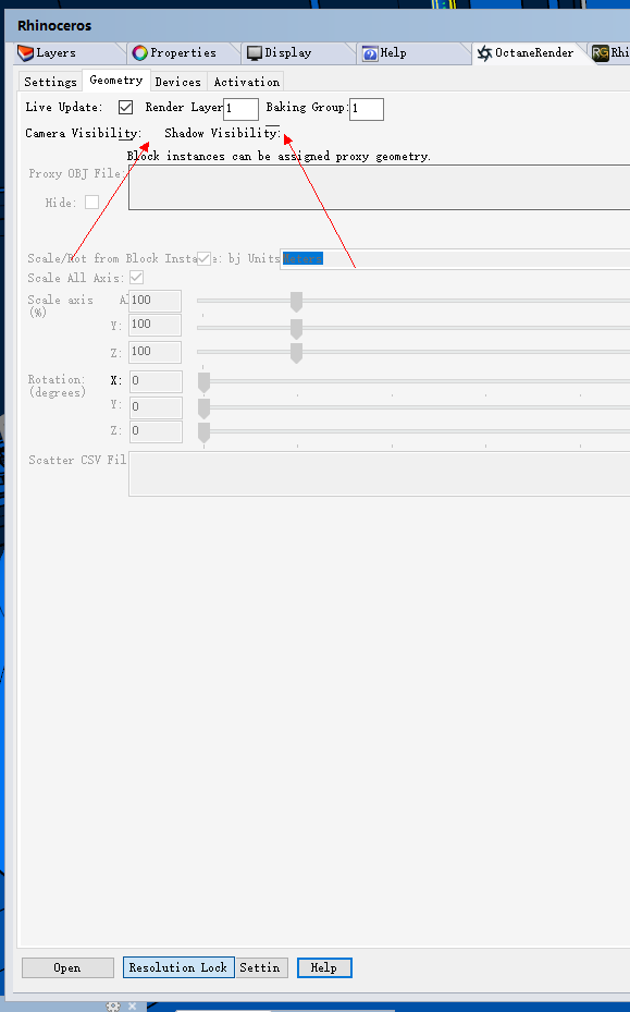

Can't check this? Is this a bug? Or my system problem?
windows 10 64bit, rhino 5 sr13, otoy 3.4.3.74
Thank you!

This is the second report of this issue. It seems to originate from Rhino using a different font to Windows on your system (ie. Rhino seems to be using Courier rather than your Windows font). I post the question to McNeel.

I delete the Courier font. Still the same.
So I google that there is a soft named Process Explorer can find which font is used in the soft,
It's not the courier font, it is a chinese font named simsun :frowning:
I delete it in the regedit (cant delete in the control panel).
Now it works.
