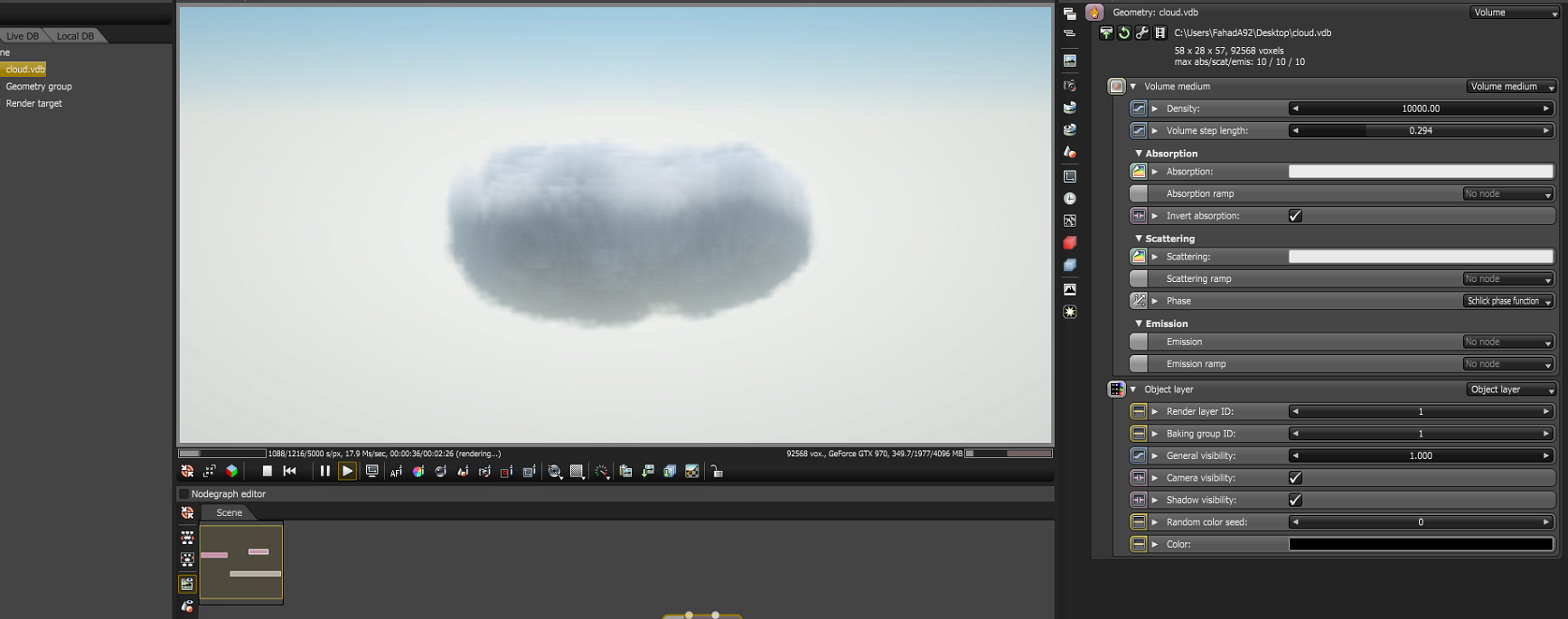

Does anyone know what's the workflow to export the Cloudfx rig to houdini? When I export the vdb via file cache, the color doesn't export to octane correctly.

Hi Juanjo,
No, I'm trying to export a cloud volume (created with Houdini's CloudFX shelf tool, " Cloud Rig") and import it as a vdb to octane. when I import the vdb file to octane, the cloud is gray, and I tried changing absorption and scattering but I didn't have any luck.

Well, I suppose that this is an environment lighting issue ... using a skylight environment you are going to get a blueish tone on top, and a dark tone on bottom. If you change the environment, the volume object will get other lighting.
In the other hand, if you need a perfect white volume in any kind of environment, you could try to use the density grid as emission grid.
