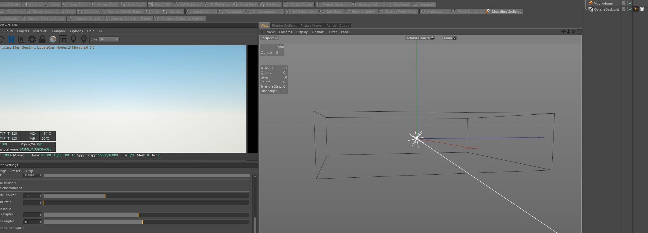

Hi guys,
I'm trying to get a hang on the V3 Volumes and sadly nothing happens when I try to get them. When creating a Volume VDB an setting it to "Generate" nothing appears in the viewport except an empty wireframe cube. And nothing is rendered in LiveViewer or PictureViewer.
File here www.philmaron.de/privat/no-volumes.c4d, using 3.04.3 and cinema 17.053. Screenshot attached!

Thank you for linking the files.. but the problem persists. Every scene without loaded VDBs wont create volume.
I thought I had made it more clear: Loading VDBs works, but making a Voxel filled Object wont. Nothing to see in the viewport - shouldn't it work like:
1. click live viewer
2. click "objects"
3. click "fog volume"
4. go to "Generate" tab and klick "Cloud1"
5. A cloud of voxel placeholder in the viewport appears.
... 5. wont happen.

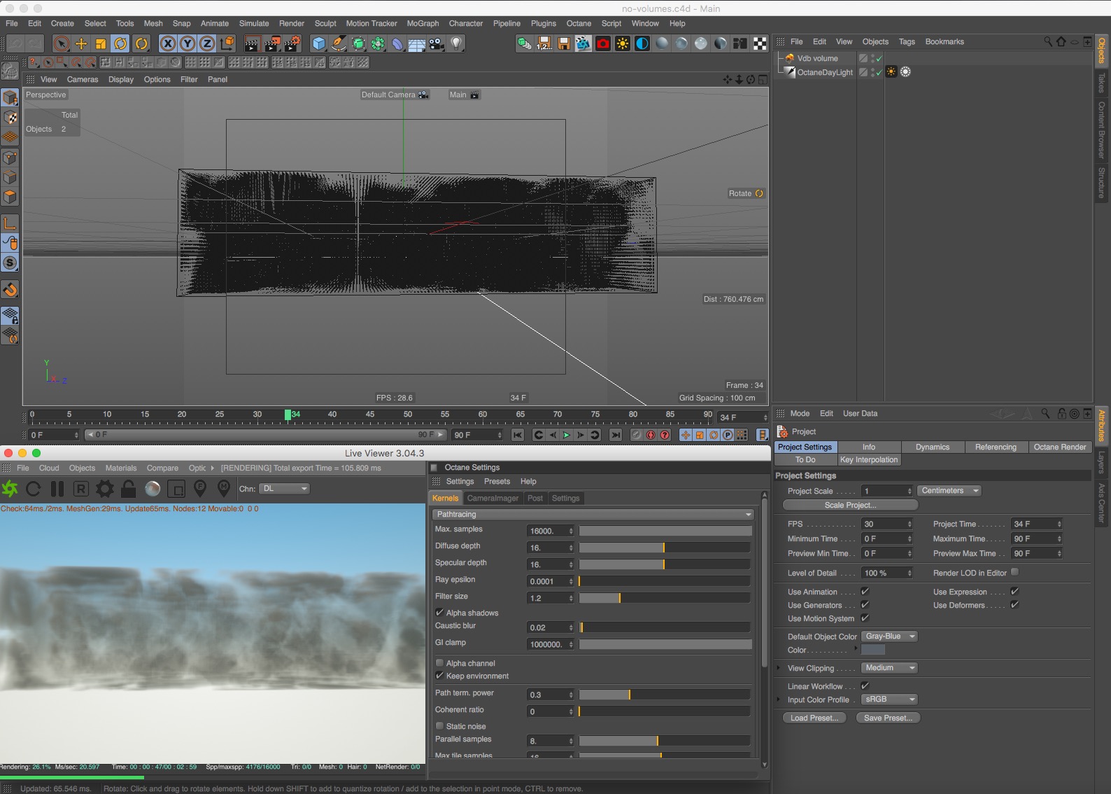

Hard to believe I guess. Check this screenshot from your example library, please.
Posts: 10622
Mmm, weird, here is your scene:
are you sure to have installed everything correctly?
ciao beppe
