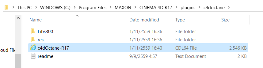

Hi. I just bought a new laptop. I already have Octane standalone running on it. I can't seem to get the plugin to show up top at all. I also have Octane on my desktop PC, and it's running fine. On my laptop, I've downloaded the latest driver. I have a 960 GTX GC. I can't figure it out since the standalone seems to work. The only thing that is weird is that the file is defaulting to explorer. I don't know how to fix it, and I don't know if that matters.
Any ideas? Thanks!

Date Modified = 1/11/2559 :shock:
I think the download might be corrupted. Try re-downloading a new copy of the plugin.
