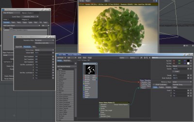

Havent had any success with the procedural volume node....tried it with nulls, meshes....every setting....seems to have no effect.
Is this working in the lightwave plug?

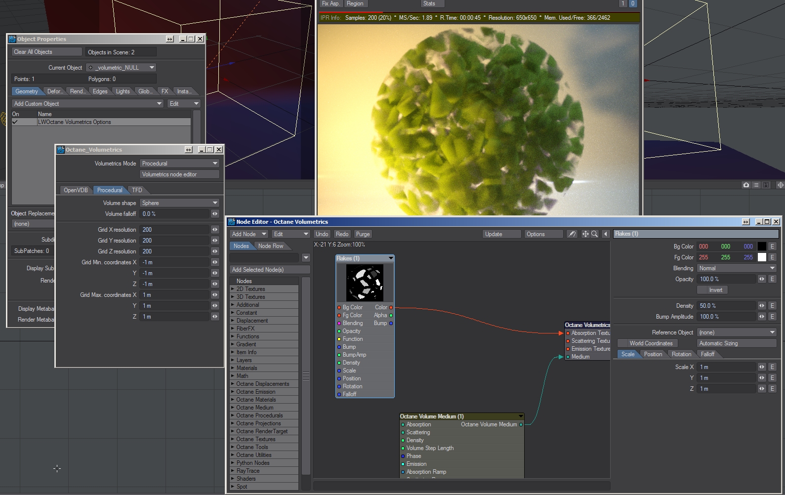

Are you talking about volumetrics in "Procedural" mode? They seem to work fine here, you only need to use the volumetrics node editor to configure them.

I got it now....
I thought the absorption/scattering texture input was optional as it the rest of volume nodes.....was expecting to see a sphere or a cube without them.

Could someone help me please, I have setup volumetrics just like in the image posted above, but I still get nothing rendering.
Completely white render. Is there something special I need to setup other than what is shown in that image?
