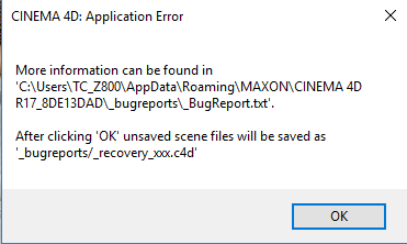

Any suggestion would be a big help. The only thing that help so far was to turn off OpenGL in the viewport, but this makes the very slow. I tried turning off Cuda in the nvidia control panel for the Quadro 4000 but made no difference.

Your crash is ended at nvidia driver. So it's most likely not a bug for Octane. How it occurs? Where? Did you tried to pull off your quadro?

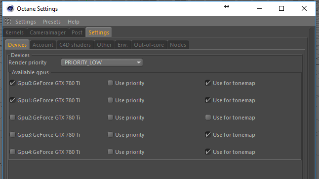

Disabling the Quadro 4000 in the device manager and using on GTX 780ti for the monitors has improved the performance a lot.
How can I tell which GTX 780ti the monitors are connected to, so I can correctly set the performance priority?

A Q4000 really should handle viewports perfectly. I would hook up the monitors to the Q4000, untick the Q4000 as render device, and let the 5x 780ti handle rendering. And maybe the Q4000 has insufficient memory for your scenes, but the 780ti`s do.
