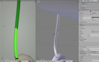

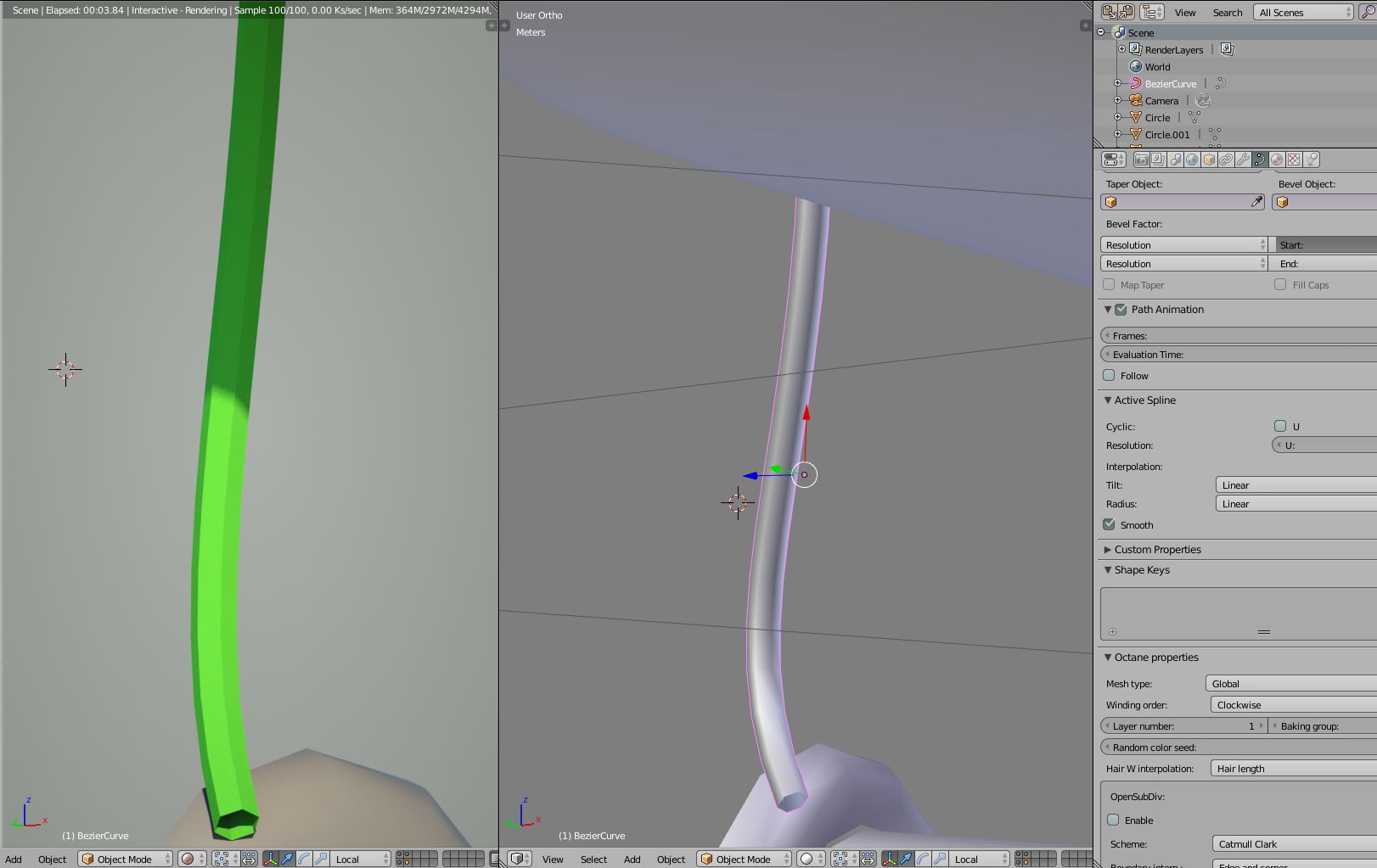

I have problem with bezier spline smooth. For example in this file.
This spline cannot be smoothed ...
Can you look at it, please?

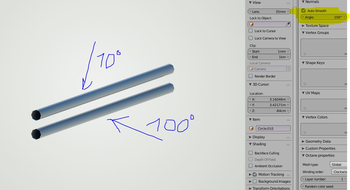

There is something wrong with "Auto smooth angle".
First pipe has 10°, second pipe has 100°, but output is alway the same in my test file.
Try it fix please ...

I see three different problems here:
1. Blender doesn't have "auto smooth" parameters for curves, so you can set it for meshes only. I will see if I could add it as Octane specific parameter, specially for curves...
2. You can't have different smooth angles for "Global" meshes. There is a thread next to yours: viewtopic.php?f=32&t=57118 where I've answered about this already.
3. Playing with your scenes I see there is a bug in a recent plugin version which sometimes yelds not correct smoothing results even for "Scatter" types. I will release a fix soon. Thank you for report.
