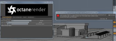

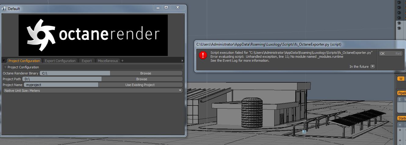

Just upgraded to SP3 and everything seems to have stopped working. I have lost the menubar item but can find the script by doing some sneaky form editing. However when I export I get a command line error, I cannot read it as the window crash box covers it. I have tried this on several scenes and have had no luck.
Just done some more tests and it seems to be exporting a 1kb file.
Any ideas please?
Any ideas please?
