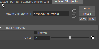

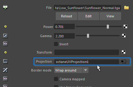

You have 4 UVsets per original object
I think for some reason an empty default uvSet map1 has been added, and is the active uvSet in your scene.
If only DiffuseUVset is supposed to be used, just copy the UVs from DiffuseUVset to map1, for the 2 original objects.
But if depending on the textures the uvSET supposed to be used can be DiffuseUVset or DetailUVlayer, or ExtraInfo
so you should had and a UVprojection node to the imagefile selecting the corresponding uvSet by numbers.
