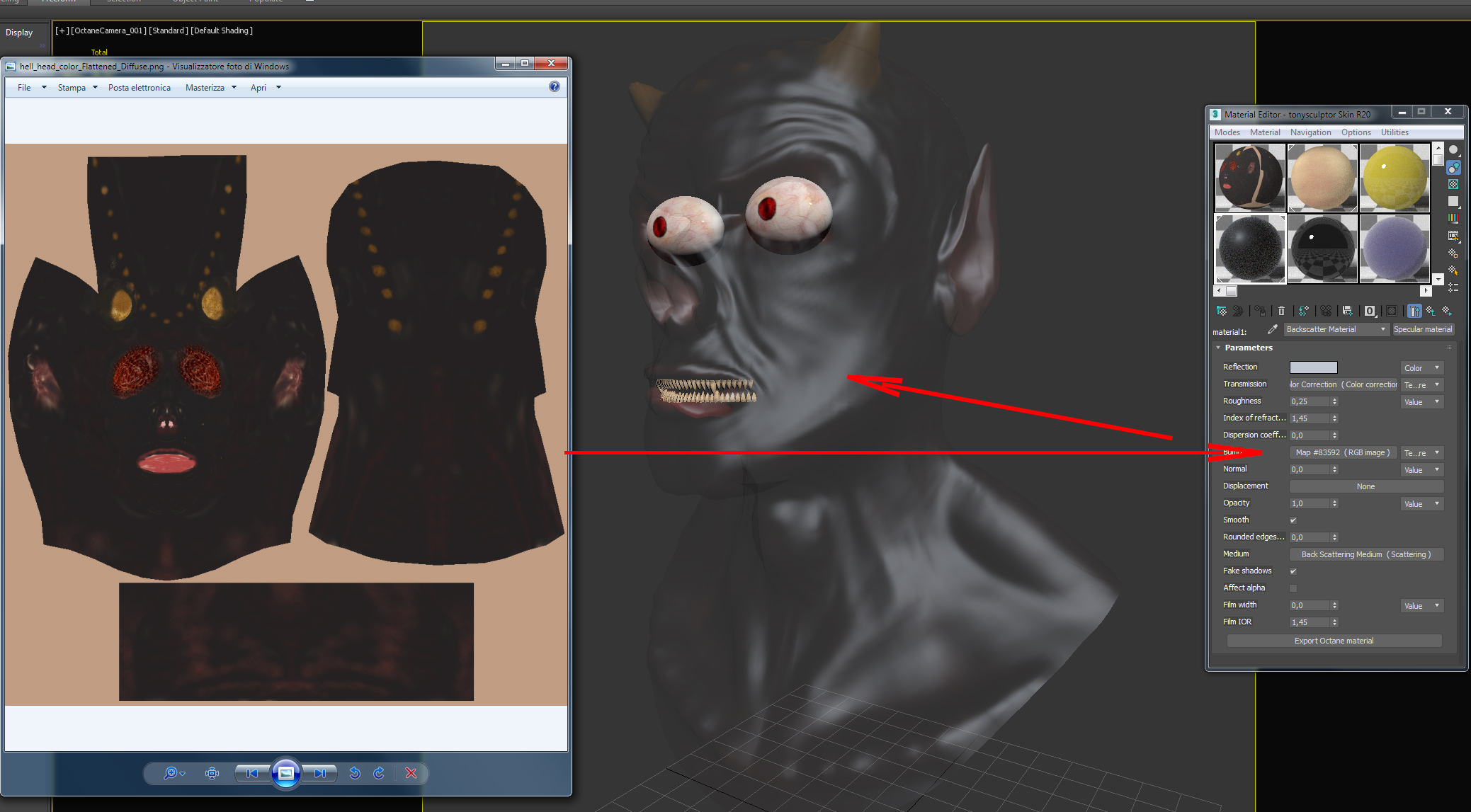

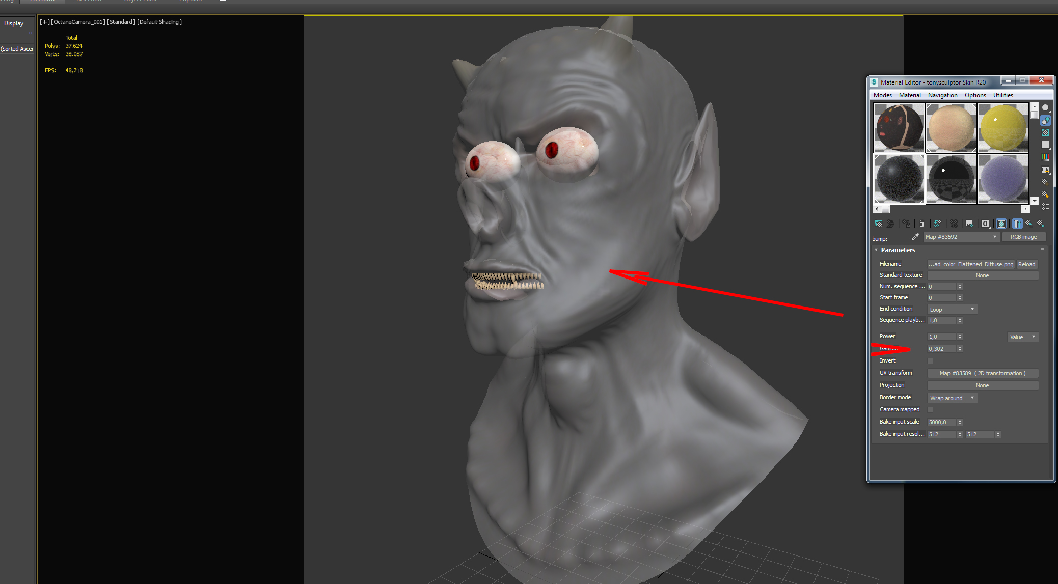

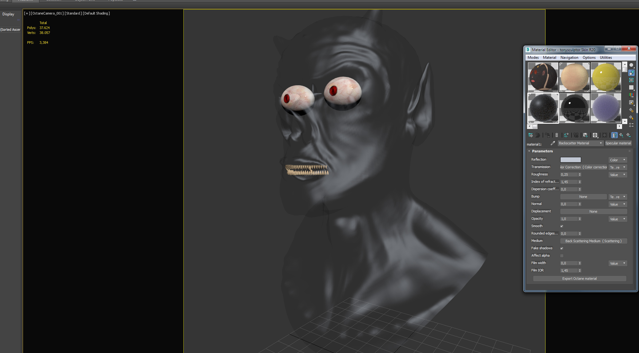

see attached picture and please IGNORE the uncorrect maps on the body..but please look at the head...you will see that its too transparent (actually the whole object is, but its more noticeable in the head due to inner parts)...i can understand why...(it's a spec material after all) but i wish that we could just preview the MAP(s) that has "show shaded map in viewport" on, and have it NOT being transparent but opaque...
if i have to animate the eye for example..its very difficult like this because i would not know where the pupils are looking at..or if i wanna see the mouth animation, its hard because the teeth/innermouth shows thru, and in this case i can't just unhide the inside parts because its all the same mesh. (daz3d genesis 3 base model)
Nildo

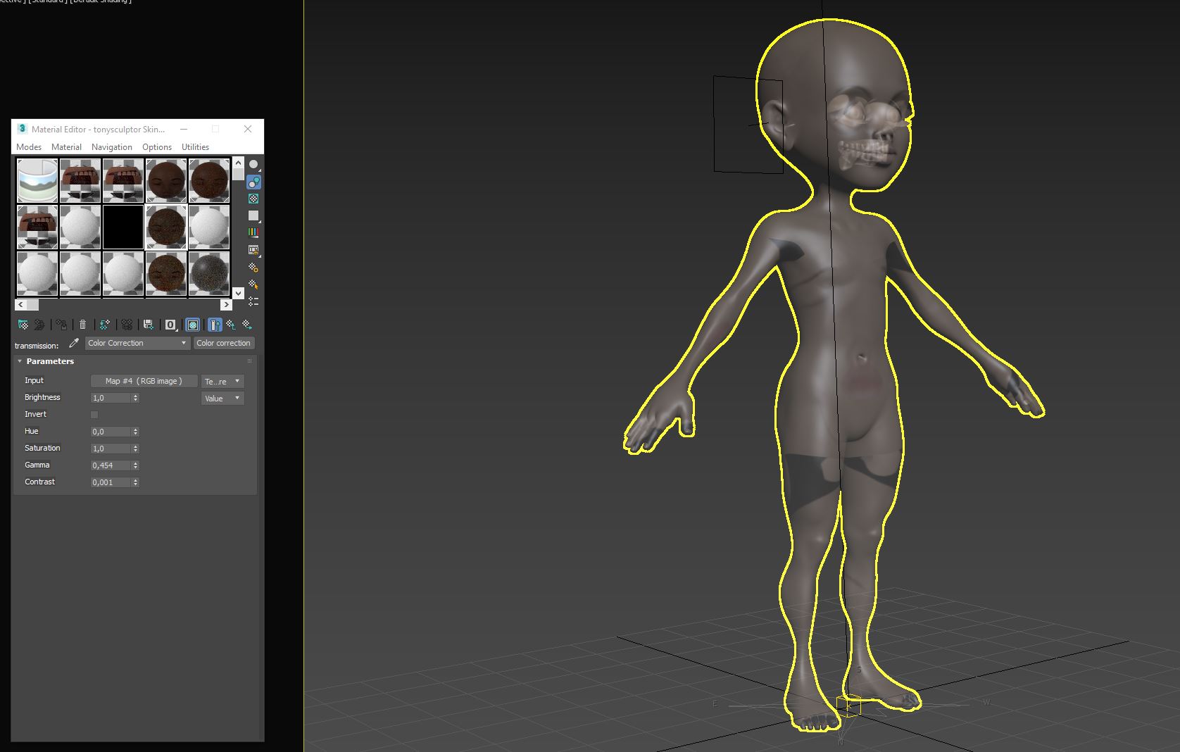

I understand what you mean, but how would you solve your issue?
I think you could use textures and "show Shaded Material in Viewport" in an unused slot,
adjusting the transparency using, for example, gamma.
Regards
Paride
