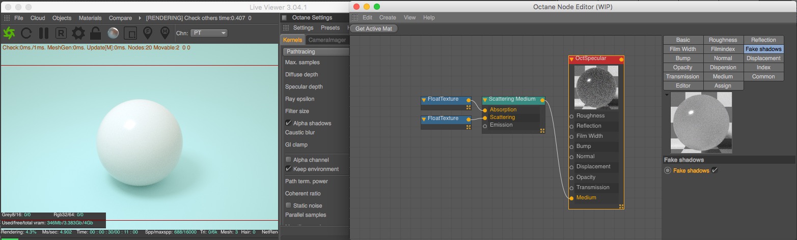

please could you post a screenshot of your material node tree?
In general for this kind of material you can use a specular material with high transmission and scattering medium, absortion white if inverted or black if not, white scattering and play with density until you get the desire effect.

Hi zsdani,
sorry, I forgot to tell you to activate the fake shadow option in the specular material:
the density value is a multiplier and depends from the scale of your object and it could vary a lot.

Thanks. Looks like it's working, but only when I'm using the PMC kernel.
