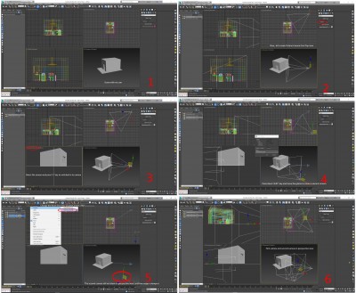

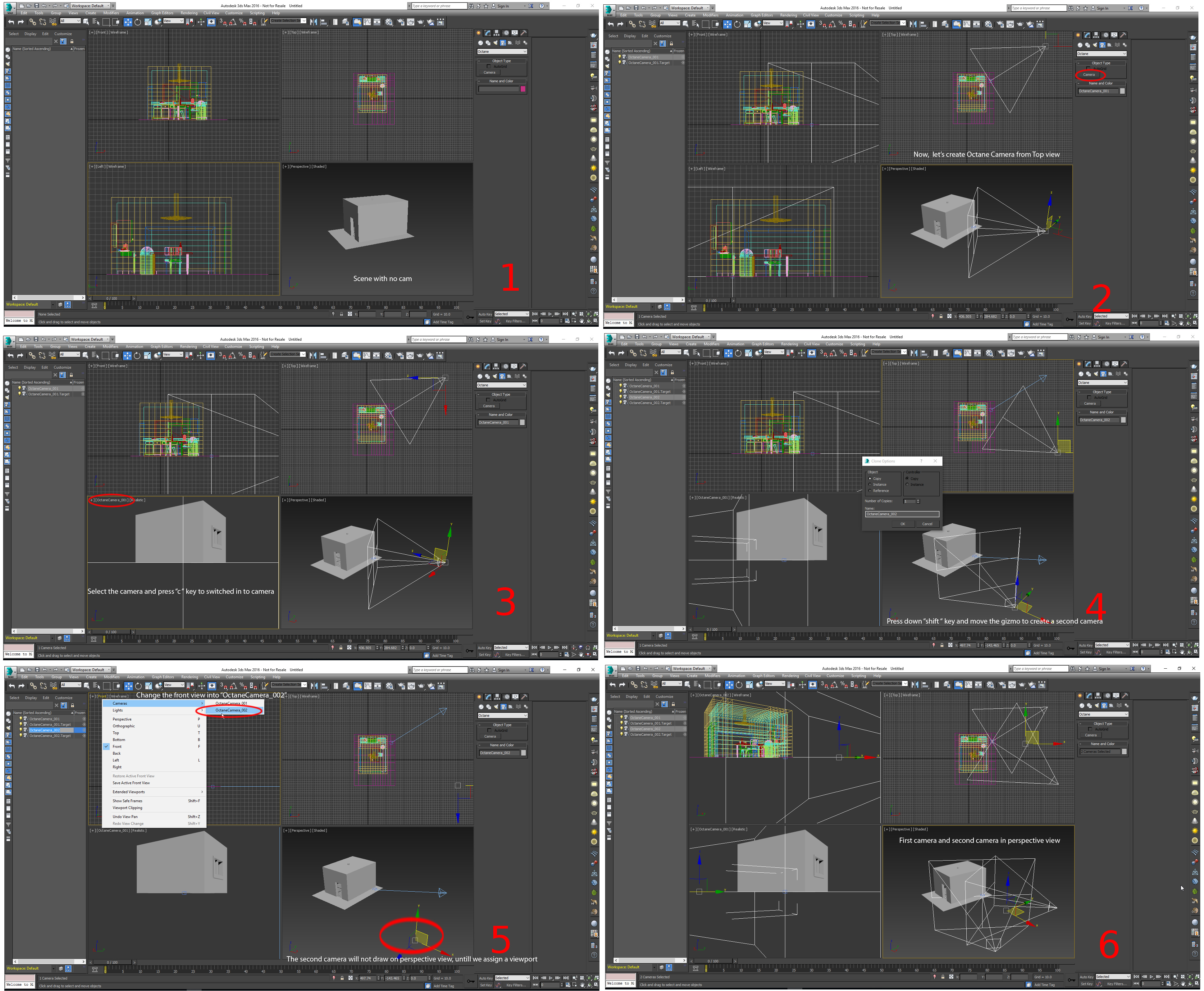

We got 2 work around for now;
One is indeed to select the camera as view camera in one viewport, as detailed in those screenshots; Alternatively, creating a copy as an instance, then choosing 'make unique' in this instance also makes the camera visible again..
Hopefully, we'll get a cleaner fix soon..
