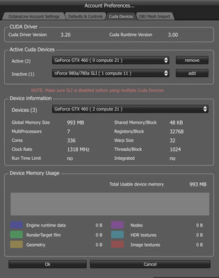

Here's how my CUDA device setup looks now, so this is after removing the Octane 3.2 build, then installing 3.0.
It's noticeably faster now, but what I'm curious about is what it says at the top. It says the CUDA driver version is 3.20, but the CUDA Runtime version is 3.00. So does this mean I'm getting the current maximum performance for now, or should I downgrade the driver to match the Runtime?
