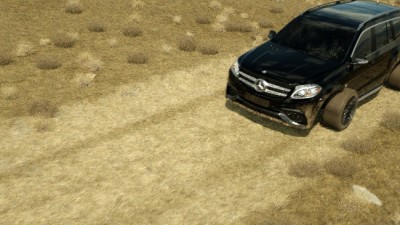

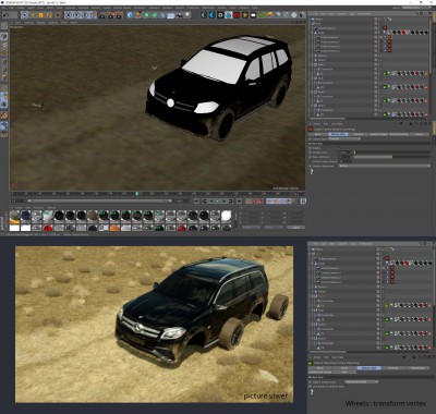

I'm working on moving a car in the desert.
When enable motion blur (transform vertex), strange thing happens
Wheels are moved from the original place. I tested a few scenes.
this problem just happened in render final (picture viwer)
The next problem is that for motion blur for wheels, must start from the first frame to be rendered.
Cache also got , but not resolved. If I render the middle of the frame motion Blur does not work.

First test it on C4D renderer. Test it without motionblur on Octane render. And just use transform motion blur.
If still have error send me your scene.

Why c4d render?
all test done
It does not happen without motionblur
with just use transform motion blur is happens (with octane objecttag) :cry:
The main problem is that it is sometimes right and sometimes wrong does it work?

new test
but
Without "octane objecttag" is Worked correctly and not Difference with Previous state
