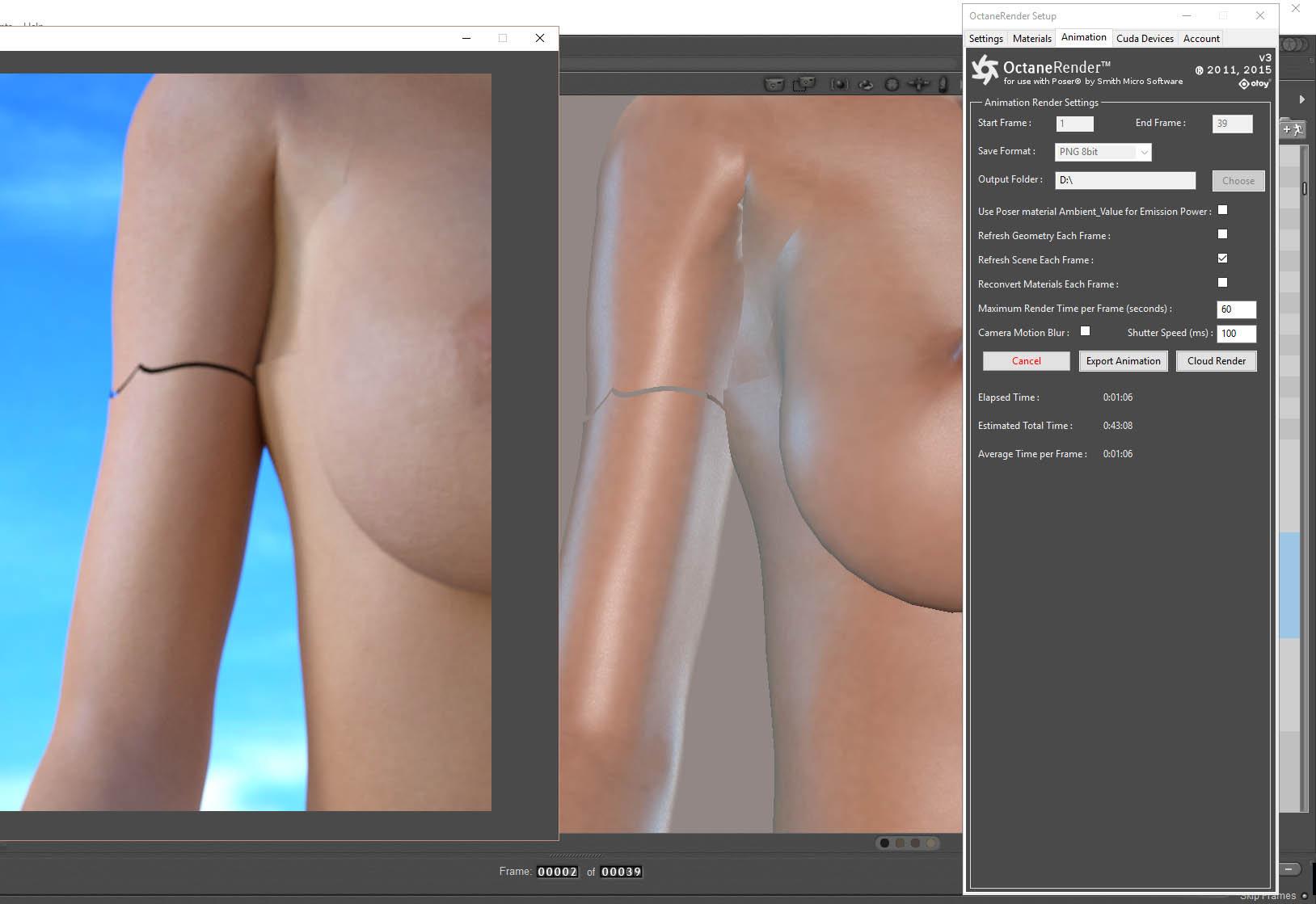

Greetings, can anyone help me with this problem? I can't seem to resolve it..
System is fully updated (Win10Pro / all video drivers, Poser Game Dev and latest Octane 3.3.4.7)
If I use Octane to render single images, there is no issues what so ever, what a dream!
Unfortunately, when I attempt to render an animation sequence, either model moving or camera moving around model, the character ends up broken in parts as in sample image. It is only then that this also shows up in Poser.. it never does any other time..
I have tried various settings and though one or two of the first animation poses will render correctly, something happens to break the model into parts for the remainder of the sequence..
Any idea what might be causing this and how to rectify it?

Hi - pls see question 30 of the FAQ - https://docs.otoy.com/manuals/products/poser/v-3/faq/

face_off wrote:Hi - pls see question 30 of the FAQ - https://docs.otoy.com/manuals/products/poser/v-3/faq/
Paul
Ah thank YOU!.. and that was the trick indeed... I had remembered seeing a note about this very problem but could not find it again.. Thank you for your patience.
I'll have to read up on the difference between Poser Traditional and Poser Unimess skin methods..
