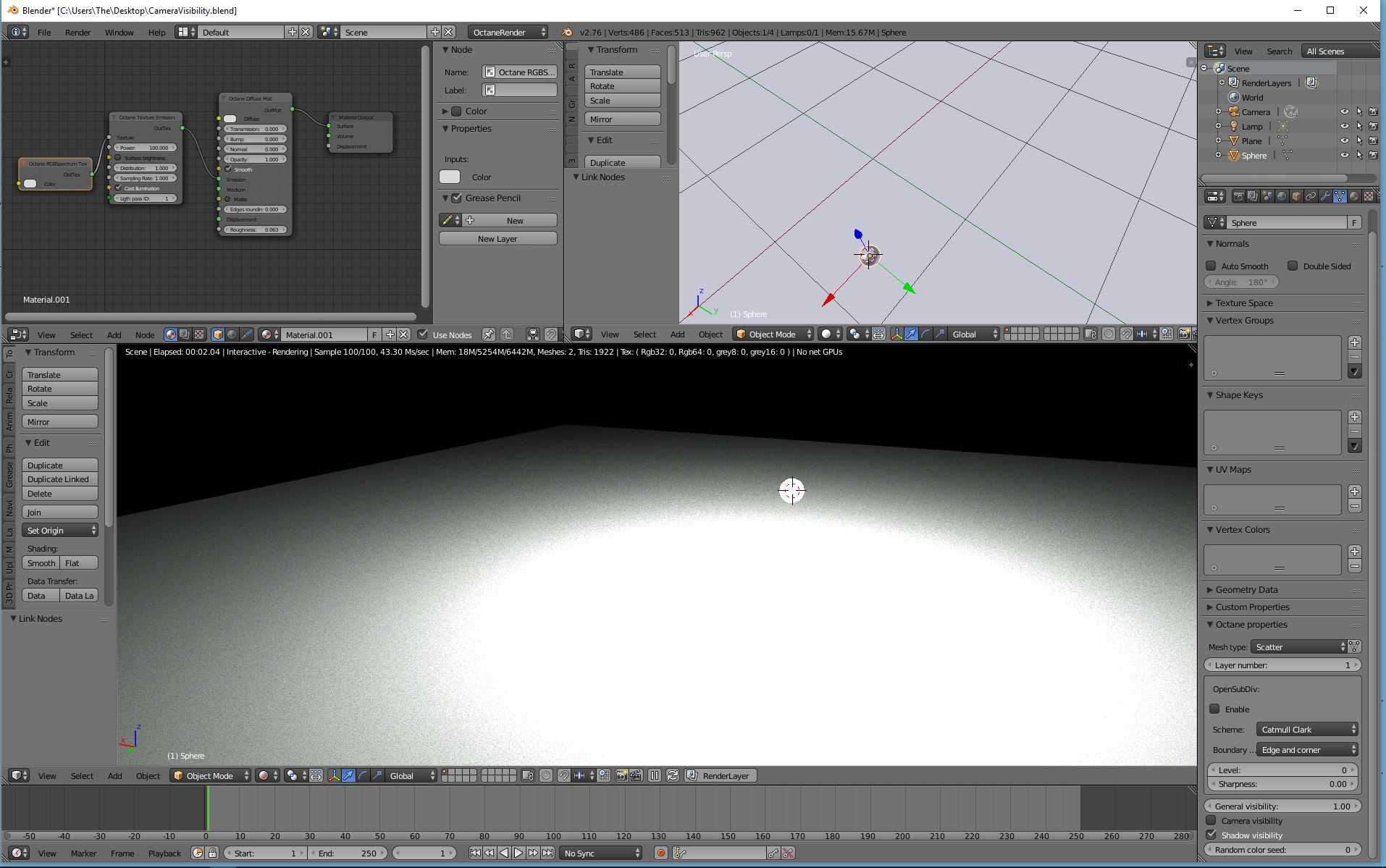

Thank you very much for uploading the file!
This is getting even weirder - please look at the attached image (and the .blend if you have the time).
Camera visibility is greyed out in my version (it was also greyed out in the old project I described above, but it did work). However, here it doesn't make any difference when I untick it.
My version is OctaneRender for Blender 2.25 - 9.13 (CURRENT).

This is the key. "Greyed out" means this function is not supported for global meshes by v2 version of the plugin. Even if Blender itself allows you to tick the checkbox, you can't expect it to work.justavisitor wrote:
Try to change the plane's mesh type to Scatter.

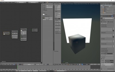

Thank you for your reply.
But then I opened a similar test project (please see image) and tried Scatter - and it did not work.
Like I said in my first post, I already tried all mesh types on my previous projects without any luck. So I don't understand why it works in my latest test and not in the other ones. I can't see any difference at all between any of my projects.
Again, it works in my old project (and no matter which Blender-version I use).Saramary wrote: "Greyed out" means this function is not supported for global meshes

Hello again,Saramary wrote: This is the key. "Greyed out" means this function is not supported for global meshes by v2 version of the plugin. Even if Blender itself allows you to tick the checkbox, you can't expect it to work.
Now I get it!
The Viewport render updates a lot of modifications in real-time, so you don't have to re-render constantly to review your edits.
But it's sometimes necessary to update the Viewport render after un-checking Camera visibility. I'm not sure yet when or how often, but perhaps it's just necessary the first time you un-check the option.
In any circumstances, it works perfectly with the Scatter setting after refreshing the Viewport render, so thank you for pointing this out!
EDIT: I found the pattern as to when it's necessary to update the Viewport render: It's not necessary when you check/un-check Camera visibility, and it's not necessary when you switch from Scatter to Global; however it is necessary when you switch from Global to Scatter; hence the errors I got.
EDIT 2: It probably goes without saying, but just in case: Shadow visibility (without Camera visibility) also works in Scatter-mode, which is awesome!
