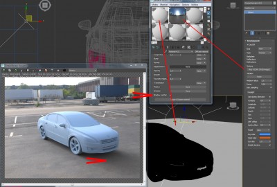

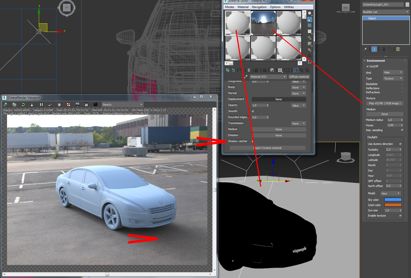

Octane 3dsMax plugin has an advanced lighting system via HDR.
I attached the link to use HDR environment:
To obtain the cast shadows of the scene, just use the common material and tick "shadow catcher".
Regards
Paride

Hi rv3d,
the parameters you're looking for is not present in octane;
you could get something similar to those with a workaround,
simply build a hemisphere and map it with the HDR.
Regards
Paride
