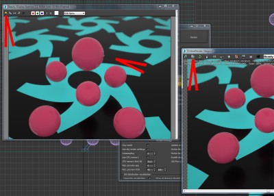

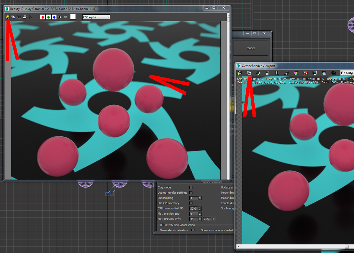

I am newby in Octane Max plugin , doing my first project. I am facing a problem while saving. When I try to save image from Octane view port or Max Viewport (happens in both cases), max crashes without saving. I tried on 2 differenr machines, still happens on both. I use max 2015 and octane plugin V3
