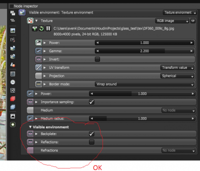

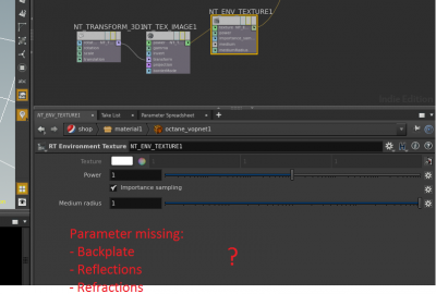

In the Texture Environment node in the houdini plugin, several parameters are missing:
- Backplate
- Reflection
- Refraction.
Normally, this allows to switch e.g. Backplate from Environment to Visible Environment when using a Texture Environment with the render target.

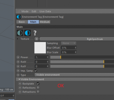

This is only missing in the Houdini plugin. In the C4D plugin and the Standalone, these parameters exist (see attached pictures).
Any chance to add these parameters to the Houdini plugin implementation ?

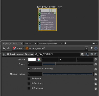

What plugin version are you using? I've these parameters here using the latest 3.03.4.0 plugin build.

Hi Juanjo,
I am somewhat new to the Octane plugin for Houdini and always downloaded the newest available version from the account downloads page.
...and conveniently have overlooked the notice in the upper-right corner to check the forums for the newest versions ;-)
I need new glasses (seriously ;-) )
So, I have upgraded to the really newest version & the issue is fixed now !
Cheers & Thanks for solving this issue so quickly :)
