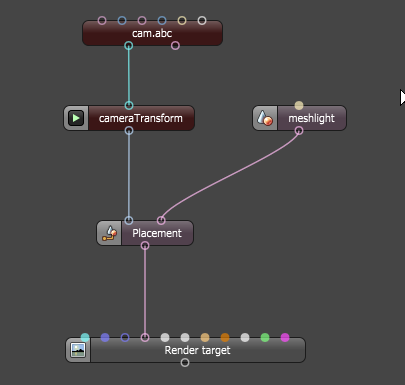

Here it is,
I took some parts from the explodeCamera script node and the camera map script.
cameraTransform.orbx
script Node
(2.82 KiB) Downloaded 1192 times
Seems to work nicely. :)
usage
usage

GREAT!!! It works! Thank you very much!
