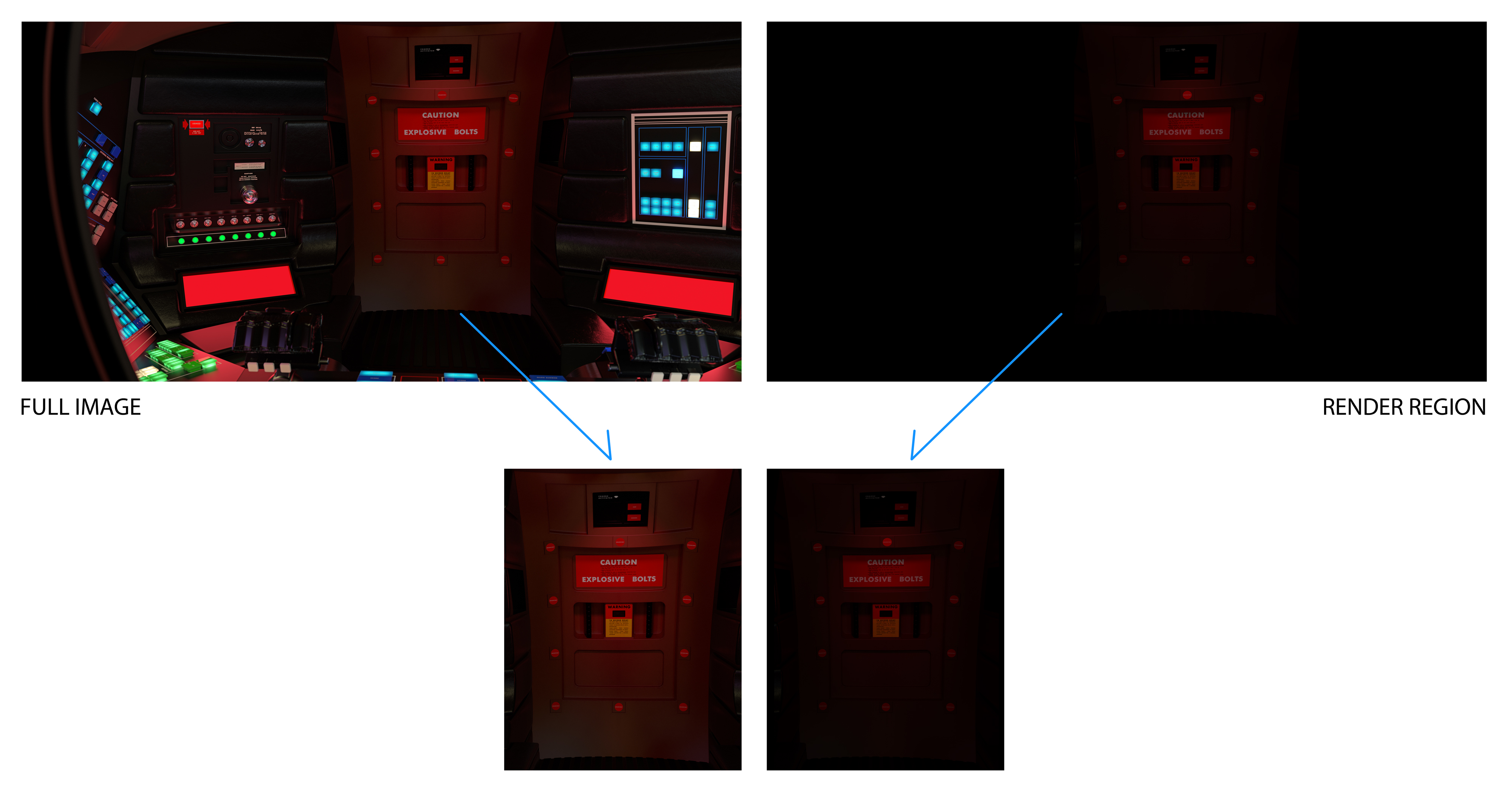

I just attempted to do a Render Region, but it is way darker than the same area in a full image. I can take it into Pshop to fix that, but I would rather not have to do that.
Wy is it coming out darker?

Here is an example:

I always save the .ocr in case something bad happens, along with a .png. To save the .ocr, I simply do "Save render state" and name the file appropriately. To save the .png, I just do a right click in the render window, and save the image that way.
One problem with this file that took a while to figure out, was getting the kernel set properly to render the full image correctly. There are 326 indirect lights (all the backlit pushbuttons and gauges), and only 10 direct lights (the lights on the walls and the monitor screens). That having been said, when I do a render region, the result in the render window itself is clearly too dark, just like you see in the saved image.
Could all of this be due to the really high amount of indirect lights?

abstrax
Posts: 5516
Are you using the PMC kernel? Usually it works fine with region rendering, but in some corner cases the weighting during seeding may produce a wrong result resulting in an incorrect brightness. Use path tracing in those cases.
