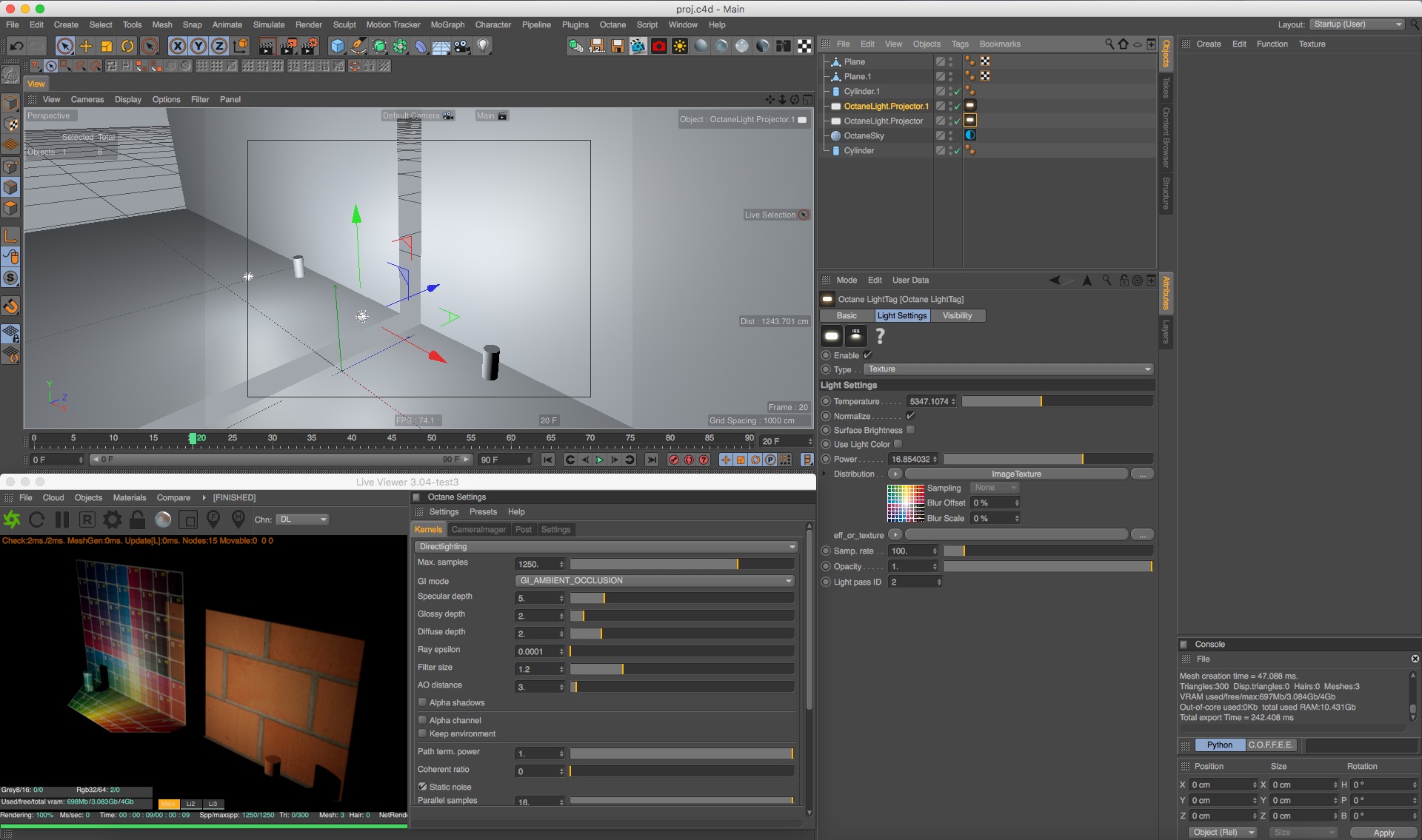

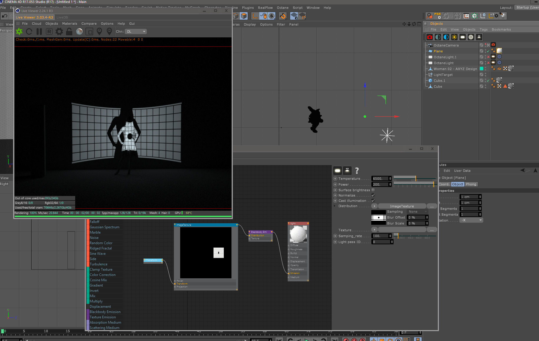

I'm pretty sure I'm doing something bad here, I tried to make s a light projector I placed a texture inside the distribution slot and after that I had to mess around the transform options of the texture to get it to project to the front of the light I got it working but now I'm having this distortion around the edges and I don't know how to fix it from here, any ideas?

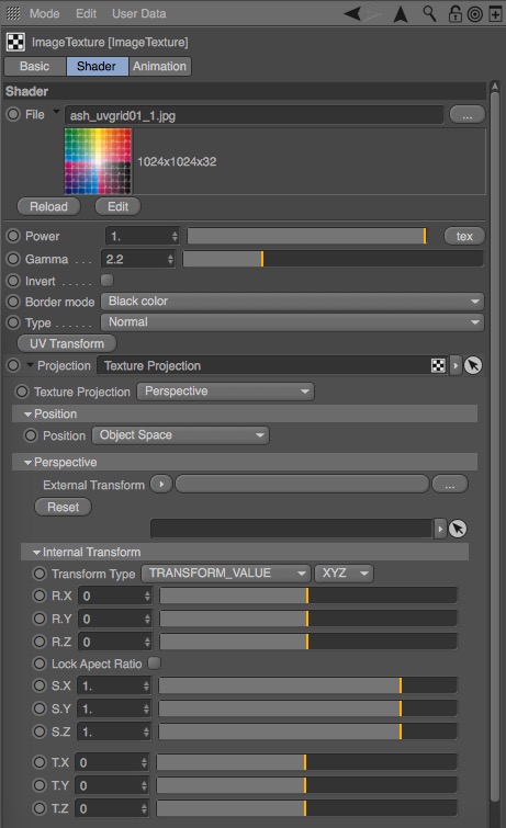

Hi Terryvfx,
I cannot see your projection node... could you try in this way?

Thank you! I added the projection node and tweak it a bit the UV transform and it's working as expected.
