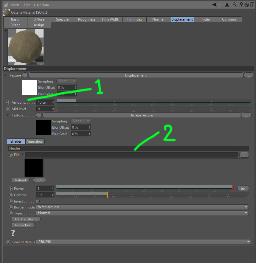

If I load a texture (or shader, or whatever) in FILE (2) the AMOUNT (1) instantly drops to zero, and then when entering a number in the AMOUNT, as soon as I hit enter, the texture unloads itself.
Similarly with Volumes when loading something in Absorption/Scattering/Emission, the DENSITY drops to 0.00001. And if raising the value, whatever you just loaded simply unloads itself.
So, changing something in one place, messes up something somewhere else

It's not completely a plugin problem. It's more about C4D sdk and this kind of usage with custom GUI's. I remember this has been answered on your other report.
It's fixed on C4D R18.

The reason for posting it that since during the 6 years I've been working daily with C4D I've never ever experienced that (again, changing a value, shader, texture etc in one place, causes a reset/removal in another place or the other way around) behavior anywhere else than Octane, not with C4D itself or any plugin, renderer, anything.

Did you see ever this kind of node system with custom GUI under materials before? These are truths what i know. I spent months to solve this and no solution before R18 for me. Don't use these as UNFOLDED or go with R18.

Sorry but i'm having hard times to understand what you mean and want!!! This is not fixable bug for R17 or olders.preciousillusion wrote:No?
And our node editor is not working on a XPresso interface. It works like how material editor do. So it's a really native way to work with materials.
