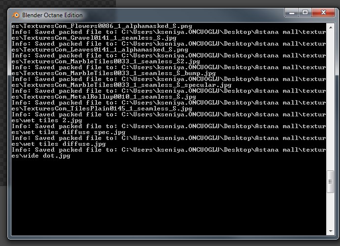

And always have a look at Blender's console for possible error messages if you are experiencing some issues...

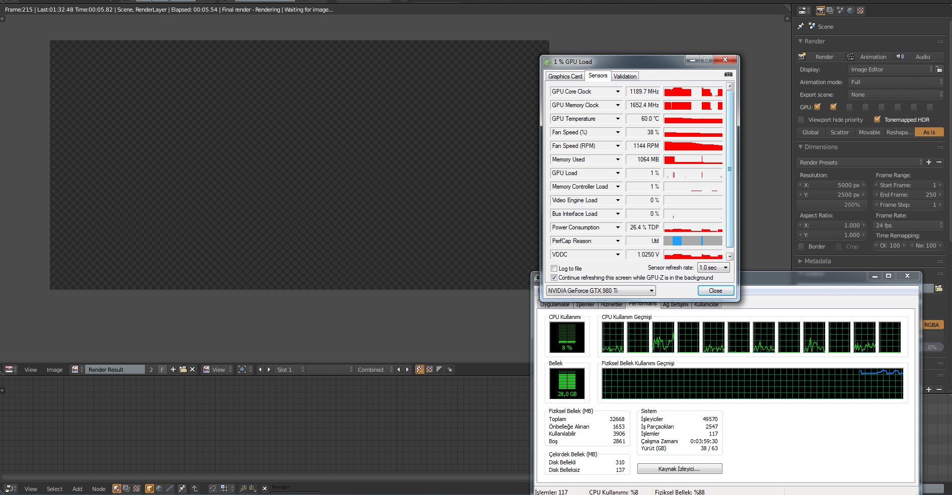

Hi JimStar, thank you for reply.
I recreated this error and took screen shots for GPU-Z and Task manager to see Vram and RAM usages. They both dont hit the limit. In console there is also no problem. The scene is not very complicated, as you see in screenshot, using only Octane environment, no HDRI. Image size is 2500*5000 with %200, so in total 10 000 * 5000. This time I exaggerated image size to recreate the problem, but ususally it happens even with sizes like 3000*6000.
So is there an output size limit, or is it some other problem?
2 x GTX 980 Ti, 32 GB ram, i7 5820K

In your case - VRAM is not enough. You don't see it fully consumed on GPU-Z because the render-engine fails being not able to allocate all the needed memory for a film buffer.
V3 uses system RAM for a film buffer, only postprocessing buffers are on GPU. So, you should have much less problems with high res renders in V3.
