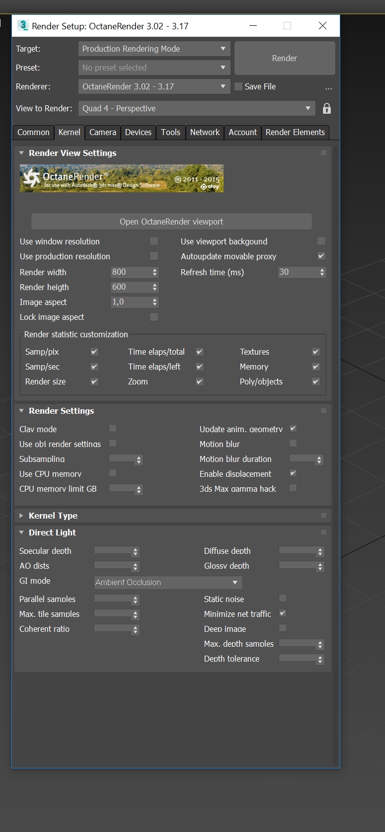

I using 3D Max 2017,Win 10. Kernel setting doesn't appear. I also tried Octane plugin 3.03.4- 4.20, results are same. How can I fix it ? Thanks already

I have the exact same problem and it's cause I have a 4K monitor so I scaled the resolution 150%. When I go back to 100% the settings are fully visible

Simple Freeze wrote:I have the exact same problem and it's cause I have a 4K monitor so I scaled the resolution 150%. When I go back to 100% the settings are fully visible
Yeah I have 4Kmonitor. Resolution is already 150% scaled. But results are same. I tried %125 scale now it is working :D Thanks for tip. I think Octane can not manage 4K monitors. Cause I have also vram problem

Hi Buraq and Simple Freeze,
3ds max 2017 fully support 4k monitors.
the problem you had depends on a missing parameter in the Octane 3dsmax plugin GUI decriprion.
I sent the issue you're experiencing to the developer of the 3dsMax plugin.
